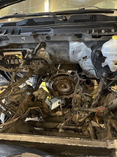

Just to rewind a bit, there was a lot of room getting the original engine out and the new long black in. A couple of things, though. I unbolted the engine mounts from the block, vs from the frame, and it worked well enough. I did end up loosening the passenger side to get it past the pan flange on the way back in, but that might have been just a small alignment thing.
I installed the long bock just with the oil pan and valve cover gaskets. I was adding long tube headers, and decided to do them in the vehicle. That was easy enough, but took longer than expected, more on that later.

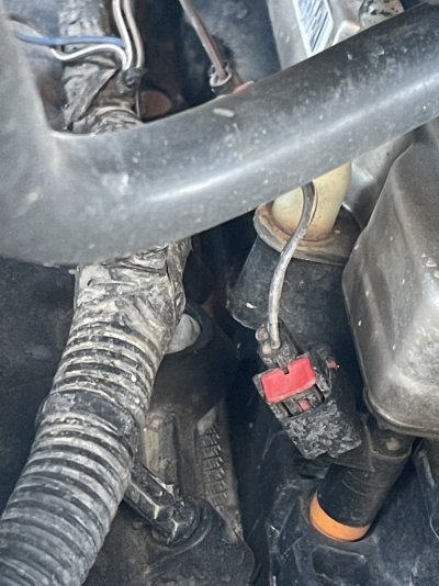

One thing to note, the main harness ground strap bolt is the exact same size as the engine mount to block bolts. Want to ask how I know? that was really the only mistake I made on the swap, but it did cause some excitement with my helper pumping up the hoist as i wiggled and pried, with the unseen remaining mount bolt silently mocking me.

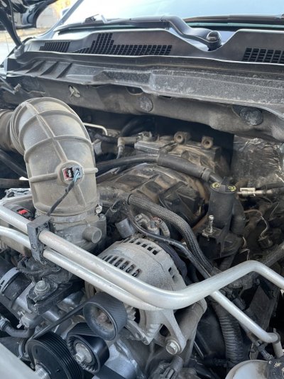

There's been a few questions about the intake manifold. I did reuse the stock 5.7l, and it seems to perform fine. One tip for anyone that is pulling their intake manifold, for any reason is to clean, clean, clean the "valley" between where the injectors sit, and the cylinder head. If you don't, I guarantee you will drop dirt/junk down into your cylinder heads. If the valve is open on that cylinder, you know what happens next. I would personally spray with water carefully avoiding the electrical connectors, and them blow out with compressed air. Do this a couple of times till you think it's clean, then do it one more time with brake clean and compressed air.
The torque values for the engine are all readily available, and honestly only two things REALLY need attention in my opinion: The oil pan and the intake manifold. The oil pan should get some form a gasket right where the timing cover seal sits on it. I made sure there was some on the block side as well.
The intake manifold required some google search engine skills to find, apparently it's top secret (kidding). Bottom line, I torqued in three stages to 98 inch/lbs. The bolts also need sealant if you are reusing. I used Permatex thread sealant, in the big white tube. I found one set of instructions that called for 108 inch/lbs, but since I was using liquid sealant (acting as lube) I went with the lower number. As with the oil pan, or anything that's rectangular and critical, start in the center and spiral out to the ends with your torque sequence.
Photos for clarity, but ignore the dust. The truck was already driving at this point , and I had been it a dustbowl at work.
You could call this "The Valley of Instant Regret" if you don't clean it well, back to the firewall on both sides.

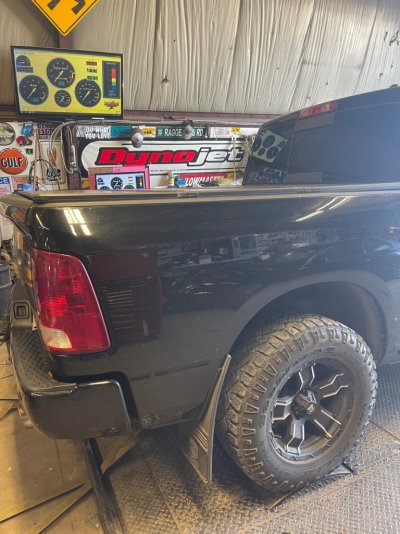

I will say one thing I see an awful lot is people are happy to spend money on parts, but they don't get the tuning. I get it, tuning is complicated and somewhat expensive. But IMO if you modify your vehicle, you absolutely should get it tuned. If you don't, you may not be seeing all (or any) of your benefits. This should be dyno (WOT) and road tuning. A good tuner will be worth it to get the most out of your vehicle, but also avoid potential for damage to your engine.
I can't say enough good things about Player 3 Performance. I was very happy with the remote tuning to get it running well, which honestly was a breeze. After a 1,200km break in, I headed North to hit up Silver Maple Numerics, and let Player 3 dial it in. This is a grass roots set up run by real car enthusiasts, and it was a great all round experience.

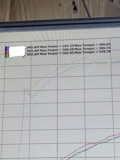

The tuning went well, but the exhaust on the truck is holding back the top end HP a bit, so I am working on changing that out in the next coming months. The truck has a much wider and much more powerful torque curve that the stock 5.7l, although for sure the tuning and long tubes help.
We did three more runs, but this was the only picture I took of the screen. Tuning it off the dyno on the street helped ensure it was all working well.

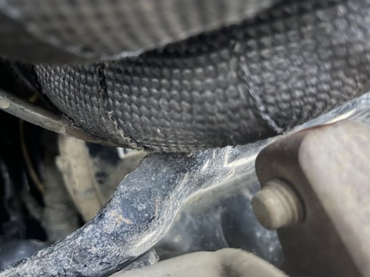

- I poorly routed the trans shift cable and it burnt on the headers, leaving me in an awkward spot. Replacement was super simple, and I routed it much better.
