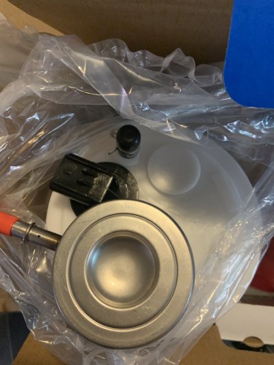

Why does this fuel pump assembly look like this?
Kevoiscool
Jan 31, 2022
Georgia
1998
5.2
You will notice that the spot for the rollover valve is sealed off. I do not yet have the old assembly accessible to see if there is a rollover valve on the old assembly, but is this normal? I ran my VIN thru a mopar parts department at a dealership, and found this part number and bought it on rock auto. E92C0AC5-BC0C-4E6E-9BAA-838A50DC16BF.jpeg

A rollover valve is usually in the filler neck at the connection to the tank, not on top of the fuel sending unit
