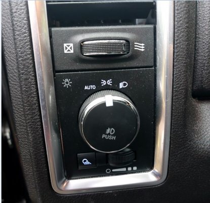

RamDiver
Jan 23, 2022
5,723
12,083
Marlborough, Ontario Canada
2021 DS
OK, I completed the test with the daylight sensor on the dash taped to simulate an after-dark condition.
As turkeybird56 had suggested, on my '21 Ram, it is possible to configure the lights so that you have both fog lights (stock driving lights) & the DTRLs (turn signals) illuminated without the low beams on.
I had successfully tested this earlier today and later tested it again with the daytime sensor covered.
