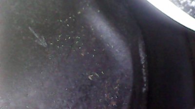

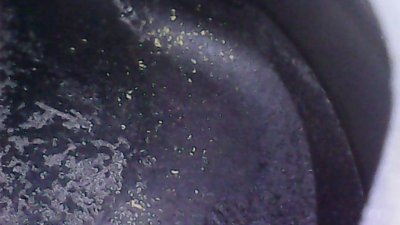

so I was going to be testing some more additives but now that I’ve had my oil catch can in for over a year now and use top tier fuel along with the ocassional PEA cleaner. I also have the exit line of the catch can venting to the atmosphere.
I took some before pics to see how effective the next fuel system cleaner I used.
Cyclinder 1 and 2 respectively.
They look pretty good less some speckling build up in cylinder 2 in the middle to bottom left of the image.
I am assuming that I am no longer getting any trace of oil vapor into the engine. My intake looks a lot better as well.
My fuel mileage during the summer has been 13.71 L/100 km or 17.16 mpg and that includes pulling a small steel trailer with a motorcycle on it.

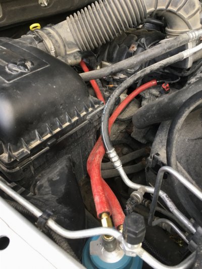

Can you post pics of your setup? Please.

I have a traditionally plumbed catch can setup, but with a much larger than normal can. It’s an industrial dryer tank that I salvaged and repurposed.
The can I used:
It also has internal baffles.
It’s mounted to the passenger side of the core support and is currently plumbed with flexible hose. I’m planning to make some aluminum hard lines to give it a more professional look.
