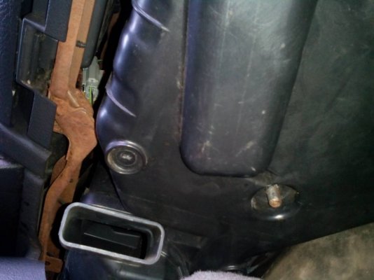

So I realized that my blend door actuator is just missing along with the little plastic pieces the screws mount to for it. I had another known working truck to compare it to and realized quickly that its gone... next question is how can I attach a new actuator without the holes to mount it to, and is that gonna solve my vent problem or hot/cold air problem?

As far as Mounting the Actuator. Can you post a pic of what you are dealing with, it will be easier to visualize. Also, as a possible solution without seeing anything, Gorilla glue is a magical thing.

Sent from my ALCATEL ONE TOUCH Fierce using Tapatalk

So it looks like you are not supposed to have a motor. That looks nothing like mine without the motor attached. I hear that some trucks were not operated by a motor and had a mechanical linkage between the knob and blend door. It seems like that is the case but Im not 100% sure. We would need someone else that has a 98 to weigh in.

I work at firestone and we had an identical 98 in the other day it had one, thats why I said it was missing. The other one had plastic coming down about an inch where those two spots are other than the rod that the actuator mounted to, it looks like on mine they were possibly broken off with the actuator im assuming??? I still havent checked the check valves you mentioned either. Im gonna do that next and see what changes.... as far as the part, I called oreillys and carquest they said it didnt exist and the dealership said they have the same actuator for all doors $44... Im just unfamiliar with this system and wanna get clear whats what before i start throwin parts at it

Here is what I have. It looks like on your truck the mounting points never existed. Maybe the motor was mounted on top? Unfortunately, I think there is a dash pull in your future if you really want to get to the bottom of this.
