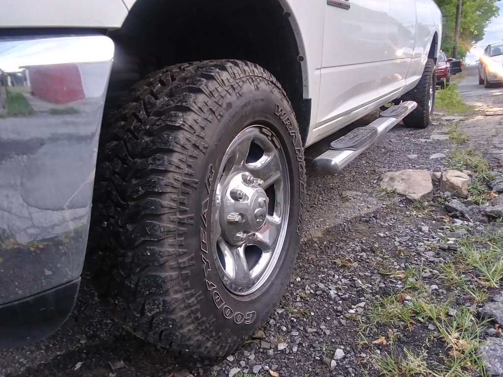

I just swapped this size from my 3rd gen to my 4th Gen 2500
I am happy with the results. They are definitely smaller than the 275/70r18 that are stock...but with the more aggressive tread they look better.
