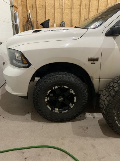

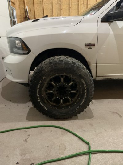

Old 315/70 r17s are worn and basically threadless. Picked these up the other day for 1000 bucks. I wanted to go back to 20” rims and the tires I might take off anyways but not before trying them out.
Theyre bud Goodrich mud terrains 325/60R20s which Meade 35” exact on the tape as they stand now. Thread measures 12/32 or 3/8”
Rims are 9x20” with +1 offset
Truck is a 13’ 1500 sport and has just the bilstein shocks at the 2.1” mark. Airlift 1000 in the back.
Go or no go?

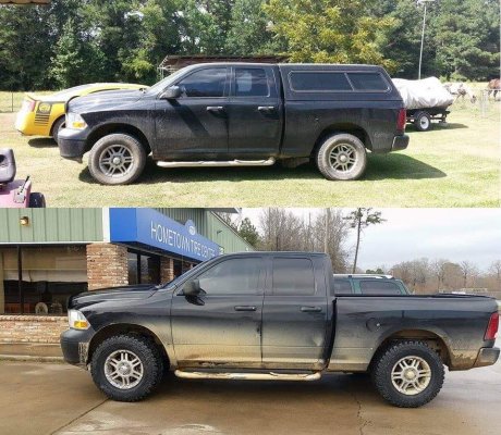

Top is level with 33s, bottom is with 35s while I was waiting for the lift to arrive. Not sure of the offset, but they rubbed the knuckle a little until I put 1/4 inch spacers on.

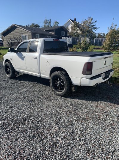

They fit, no zip ties necessary. I did however trim the top of my mudflap on the inside. They just touch sometimes when you turn hard. I was afraid of in reverse I’d rip the mud flap off lol. I’ll post pictures the next nice day we have

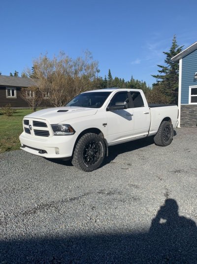

New wheels new look

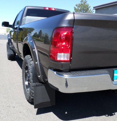

Or you can go with the set back style. They are pre-drilled for the Ram by DuraFlap.
Easy install.
