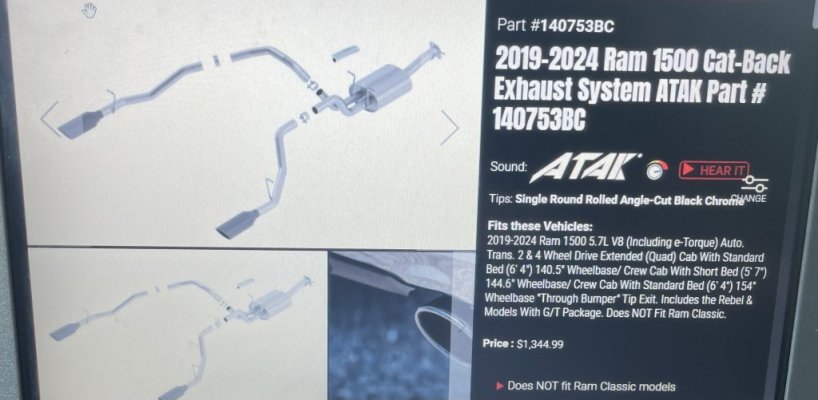

Hello I have a 2020 ram 1500 with the 3.6 v6 engine. I’ve heard that some have got good sound with v8 catback systems on their v6s. I am wondering will the borla atak v8 catback exhaust system fit my 3.6 v6 ram? I’m sure some modifications but overall is it possible? I rlly hate the s type system it’s too quiet and heard some nice v6s and wondering if this is possible. Open to other options too send links!

I'd reach out to @Nick@GotExhaust here on our forum as he is a trusted supporter and vendor here. He'll steer you in the right direction!
My $0.02 - putting on a V8 engineered cat back on a V6 may not net you the results you're hoping for. It could sound like an ill import vehicle...just saying, Brother!
If you're not going for a properly engineered V6 cat back system, then at least talk with Nick about a reso delete (I think the V6's have resonators..lol) and a performance muffler and tip(s).

When you are paying for a system, especially a quality one like Borla, you are paying for the engineering and R&D from them. They design the system to fit right, sound good, and to minimize or eliminate drone. Putting a V8 system on a V6, you will have to fab the connection point where it mates to the stock exhaust but it will fit otherwise, then I can not say how it will sound or if it will drone. It will be fairly loud, and I think that is what you are going for. May be worth looking into MBRP V8 kits as well then, a lower price point will be loud and have a deep tone for what it is. Borla and MBRP are going to have the deepest tones, which is what I would recommend on a V6. Most of the purpose made V6 exhausts are going to be louder than stock but quieter than most of the v8 kits.
let me know what you want to go with, we offer most of the brands.
