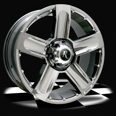

Well scratch the 20x10's, I ended up ordering a set of these instead. Remington High Country PVD Chrome 20x9 w/ 0 offset. Now I just need to figure out if I can get away with some 35x12.50's on them....

Yea I wasn't aware of that either. Discount Tire carries them, they were on sale for $120 off and came with an extra $160 in rebates so they ended up somewhere around $900 shipped. I couldn't find any negative reviews on them so I figured I'd give them a "shot". (get it?) :crazy:

Damn bro, you got hosed. Wheel/tire combos are the way to go. I got my 35x12.50x20 and 20x9s together for 1450.
And what were they, black steel rims with Federals? lol PVD Chrome ain't cheap. I'm not a fan of black wheels on dark blue trucks, not to mention it seems like everyone has black wheels these days. Also I want to reuse my TPMS sensors so it didn't make sense to buy a package and then have them dismounted and remounted again.
