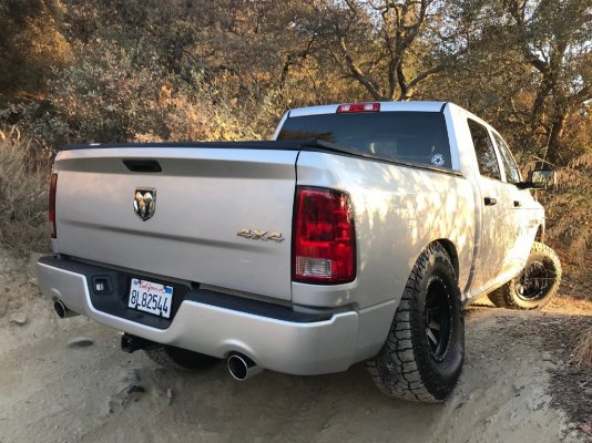

I have 17x9 wheels with -12 offset and Falken 315/70/17 at3w, which are pretty much 35’s, with 2” lift in the front only, and I have zero rub in the front on or offroad. Don’t know if the Zone ucas I have and their caster correction, are playing a role in that.
The rear rubs slightly in the fender liners at full tuck, if the tire was an MT, itll press more in the liner and possibly the edge of the fender, but that’s with factory height in the rear, I’m not running any coil spacer or anything in the back.
