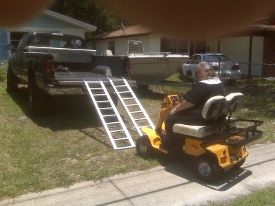

My wife is disabled and I winch an off-road (off-sidewalk?) "Cricket" scooter in and out of the bed on a regular basis. The scooter is like a small one-person golf cart. The Cricket weighs around 500 lbs and I had it roll down the ramps onto me ONE time. Learned the hard way that was a big mistake...
I simply took a piece of chain and hooked it between the forward tie hooks in the bed and use trailer safety chain clips to attach a 1500 lb Harbor freight special winch to the chain. I extended the power wires so I can get to the battery. Works great and is easy to remove and stow away.
The pic is of my old '98 RAM but I do the same thing in my '12. I also have solid ramps now instead of the "ladders".
