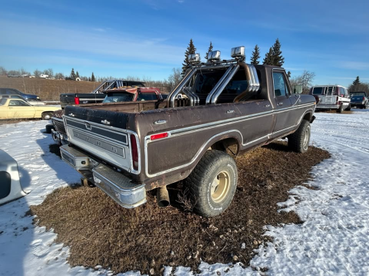

No Ford used to mount them to the inside of the box on the fleetside trucks.
If you look close at the front part of the rollbar on the drivers side,you can just barely see the top part of the spare tire mount.
Only picture i could find ,and it's not great,lol

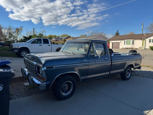

Found another pic,with them mounted at the back of the box.The mounts could be used at either the front or rear of the box,depending on your tastes and use.
