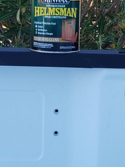

Hi all, so I have these interesting bolt holes in the bed and before I have the bedliner sprayed in I would like to add some sort of anchors to use as tie downs. What are you folks using? The holes under the urethane can....

Mine has cleats from the factory in those places. Like a marine cleat.
You don’t need them in place for the bed liner; they will just pull them off to spray anyway. Just stick some bolts in the holes to protect the threads and tell the sprayer you want those holes preserved and not filled in.

I took the truck in to have a leveling kit installed and while there I asked at the parts desk if I could order the tie downs. Parts said that they no longer were orderable for some reason. Prolly saved me some $ as I found them on EBay for $19.99.

Visit a marine hardware site pick up some stainless cleats ,and backplate material. Then choose your desired locaction to mount , look very closely under the bed for obstructions, so as to not damage things .then drill and mount in your needed place.
