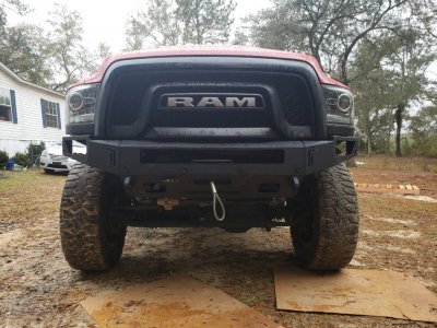

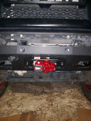

here is my 2018 power wagon with stock and aftermarket chassis unlimited bumper installed. check out my thread while you all are at it :) also, the factory winch doesnt get dirty at all.

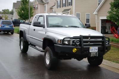

I have had two of these Bumpers: https://www.buckstopinc.com/products.html
1. 2001 Ram 2500
2 2008 Ram 3500
These are incredible bumpers.. Unlike most bumpers like "Ranch hand" it is designed to collapse on the sides during an extreme impact saving your frame... do not think for a moment it is a weak bumper--ITS NOT!
The Brush guard is also removable without having to remove the whole bumper! The winch controls are easy to get to also..
These are very nice bumpers with no showing welds for the most part..
Love these bumpers!
