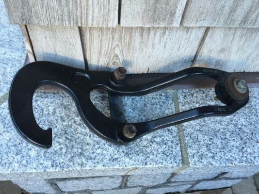

I think so. Use grade 8 bolts though.
Maybe you can find some pics of where the other attachment points are for the hooks, and fab it to connect there also. I honestly think that the front mounting points on the hooks are to simply "hold them in place" and don't really absorb any shock.
There is also a bushing inside the tow hooks, where they mount inside those drop brackets. (I think I remember that correctly..I'll look for a pic of my old ones).. may help to have those.. maybe not?
AustinB
Banned
Sep 8, 2015
3,942
2,053
San Diego, Left Coast
Bushings are in the front holes also. I stand corrected.
