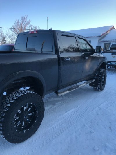

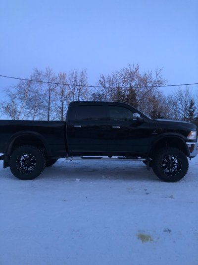

I put a set of the tape on type on an 05 and if for some reason you have to take them off, it can be a real pain. My 2011 I installed the in channel type AVS and haven't had any issues at all. If you follow the instructions and use the sandpaper to remove the fuzz from the felt in the channel, you shouldn't have any issues. I like the in channel look a lot better. As someone else said it is a smoother look.If you install them in the winter leave it in a heated shop with the windows closed for a day or 2 and if they’re cleaned properly before installed there will be no issues, I’ve had em on for a couple years now and haven’t had a problem but maybe I got lucky
