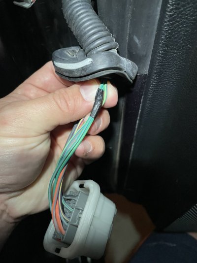

I’m in process of doing it right now. All the wires in the boot seemed to be fine and nothing is frayed or cut

this is a quad cab rear door
issues usually can be found in the wiring harness, between the door & the "B" Pillar
Just for the heck of it
look below the door latch, i think that is where the Child Safety Lock is located, it may or may not cause an issue
Good Luck

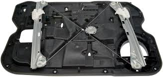

Currently in this stage of it. Accidently hit the down button so the window is almost completely down now. :emotions122:
Debating on how far I should go because I’m not sure exactly what I’m looking for if I’m being honest and I don’t have a volt meter handy. I’ll have to get one tomorrow.
