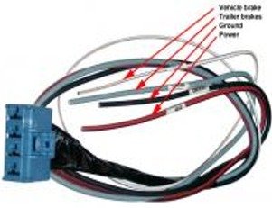

Why did they use substandard plastic for the early dashes? Why did they use substandard metal for the early valvesprings? Why did they use a transmission that was barely adequate for the power the engine in front of it makes lol? All good questions; answers? Who knows? You need the blue plug harness to hook up a brake controller under the dash. Didn't get a controller from the factory until well into the 4th gen run. This:
Goes here:

Will got the brake controller installed. Found the blue plug and found the brake wire in that plug and connected to it. Ran blue wire and power to the plug at the rear. :put twobreakers one for the controller and one for the power. Bottom line it works.
