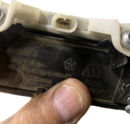

Hey guys... I need a little help here. I've been searching on your site, however I'm running into some issues. I am looking for the wiring harness that connects from the left and rear latch so that we can make this tailgate functional.
The part that is confusing me is we have the side latch part number of P68812079AL, but while searching the website, I'm only seeing side latch part number 68309893AK.
Either way, I'm trying to find the wiring harness to connect these two to the tailgate handle. Pictures added for some hopeful clarity.
Thanks for your help!

Hi,
What is the application? Can you send the VIN?

Hi,
- Benny
We are working on the development of an electric tonneau cover. My team in Australia only purchased a truck bed to test fit it on. Didn't do further research into the electric release, and right now we cannot get the tailgate to open using the release. So I'm afraid there is no VIN.

Ok what year and model truck are the parts from?

Use 68467817AA if equipped with tailgate ajar warning lamp, Use 68467819AA if not.
If the tailgate is equipped with any cameras let me know as it will also differ.
