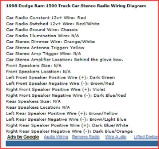

It comes from somewhere into the radio. IIRC its red with a white stripe. According to the chart i was looking at, it said there was a plain red wire with a constant 12V, but i didnt see it. I didnt look very hard either though. The 12V switch wire switches the radio on when the truck is on. The wire is dead until you turn the truck on or to accessory, then that wire is supplied with 12V to tell the radio to turn on.
Ill post the wiring chart I used. From about an hour of research, and from my expirence being in there, I'd say its accurate for most if not all 2nd gens. ab4a4b95867d9237b781e94124ec53a8.jpg
