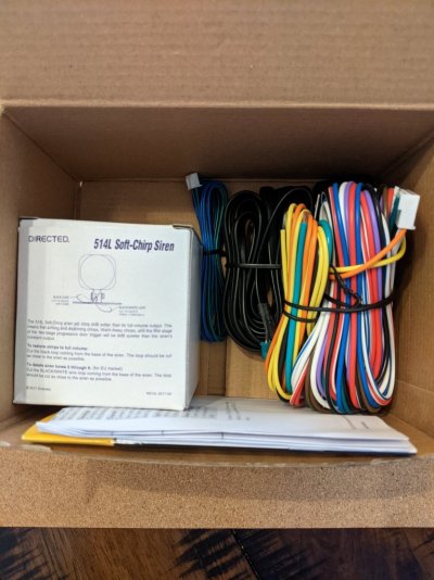

Has anyone installed one of these on their truck? Do i need anything else besides what it's shown on these pictures?

You may want to look into adding the factory remote keyless entry with AlfaOBD.

The Viper does not add auto lock/unlock. It adds an alarm system to a vehicle that is equiped with factory lock/unlock and replaces the factory fobs.

I woold also recommend considering an OEM RKE system. As a bonus you could do Remote Start for the same cost. If you’re prepared for a bunch of reading, start with the thread SitKneelBend linked above, then look at this thread:
As to cost, I THINK you can buy the OEM remote start kit with the new RFHub, 2 key fobs, a new hood latch, and all the wiring you need for $275ish, then you’ll have about $150 in the OBD interface (OBDLink MX+) and AlphaOBD download.
