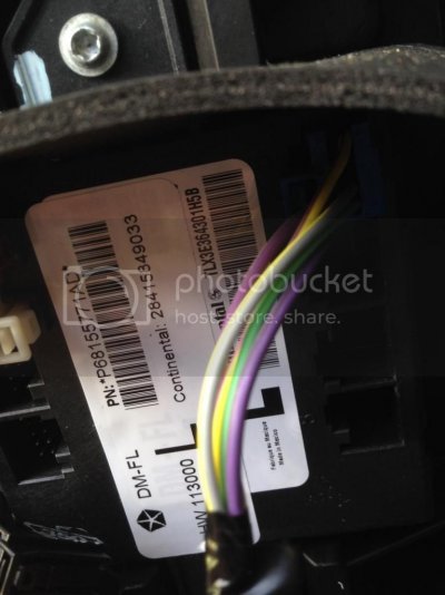

I just want to post about my successful mirror upgrade
truck-2014 Express quad cab with factory power heated mirrors
upgrade mirrors-tow mirrors with blinkers, puddle lamps, power and heated, factory but bought on ebay from salvage dealer
door modules-FACTORY modules, unchanged, part numbers below
left side - p68155771ad
right side - p68155770ad
sales codes- "LEB" and "LEC" (separate codes for blinkers and puddles, found online)
had truck flashed today, tech had not done this swap before and i had to provide the sales codes to him.
installed mirrors and they are now fully functional, i had tested the mirrors BEFORE i had the truck flashed and the lighting did not work.
not sure if it was the sales codes that we used or if i have different modules then some of the others who have tried this swap and been unable to get the lighting to function.
hopefully this gives some guidance to people looking to makes this swap!

I'm gonna have to try this out! Are these the folding tow mirrors like on the 2500 and 3500s?
Also, can we see some pictures? I'm curious as to what you mean by door module so I can check my own and see if I can do this mod, because I want the big tow mirrors on my truck.

Thanks. OP - still kind of hopeful that I could be as lucky as you. Is there anyway you can take pictures of the connectors and door modules that yours has?
SuperTrooper
Jun 2, 2014
312
32
Douglas, GA
Alright guys, I just pulled off my panels on my 2014 Express, I have the same door modules as the OP, and have pins where the puddle/signal light plugs in.
I will be ordering some tow mirrors in the next few weeks and will let everyone know if the sales code flash makes them work.
It could be one small step for Ram, one giant leap for Ramkind!
