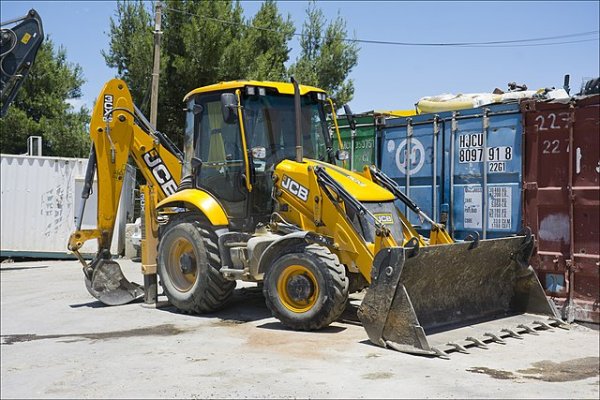

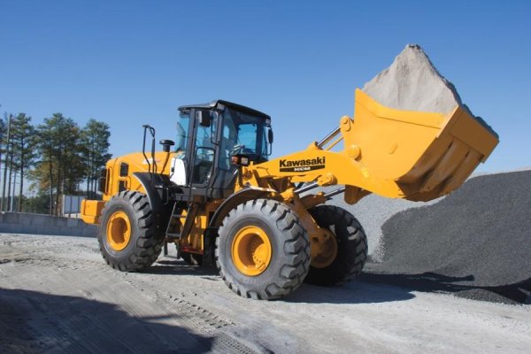

I hope that who ever loads your Ram, uses a BackHoe or Skip Loader, the front bucket is smallish, holds about 3/4 to 1 1/3 yards
Where as a Front Loader, bucket is much wider & holds at least double that amount
May i suggest that you lay down a plastic tarp that will cover the trucks bed bottom & both sides,
also lower your tailgate while who ever is dumping the soil into the bed.
Doing that will protect your paint & the tailgate
Even a expert equipment operator can slip when working with hydraulics

A little loader like that shouldn’t be a problem for a good operator. Might want to have a little less in the bucket though lol. Fooling around I’ve loaded a 5 gallon bucket with a 988 mining loader. I think you would be better off just getting a tandem gravel truck to deliver it to save time and hassle
