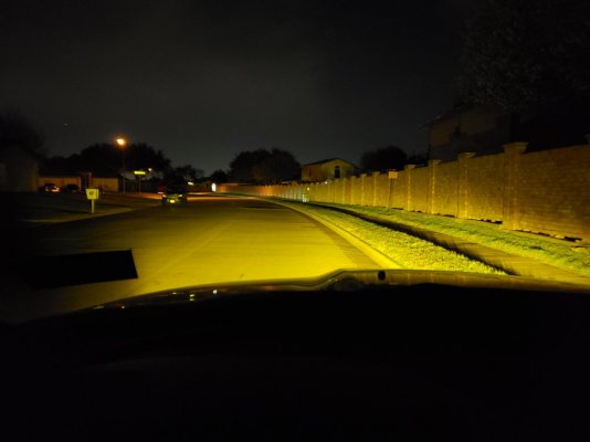

So that was something I liked about the non sae, to each his own. The non sae you see what I said in first post periphery. It seams brighter because you see everything to your immediate left and immediate right. It has incredible vision for the first 25 meters. Mind you I have no real fog comparisons for the two different ones, but I loved see everything to the left and right of me right at the bumper = non sae.

I just posted it and why I prefer non sae. What that didnt show was up and down versus periphery. But if you try the periphery option, many people would opt for it. When it is foggy, I imagine you are going very slow anyhow, not sure you would know the difference, but there is a real difference with periphery, it is amazing no joke. I doubt anyone will ruffle feathers with yellow fogs and sae, but if that is a concern do what big brother asks and go full sae. I'm glad for the discusion, now I understand the difference, and still would buy non sae and risk it because I like seeing the entire fiield of view in the first 25 meters, what you don't get with sae, you can see the previous post. Sae has better down range view, non sae has better side view, as long as it is yellow, I doubt anyone will care. I never had any complaint and someone flashing me nothing, and I live on country roads.
The DiodeDynamics SS3 SAE fogs do a fantastic job of lighting up from curb to curb. SAE beam keeps most of the light below a sharp cut off, doesn't limit the width. Most of the time they're plenty to drive with.
When looking off axis at a super bright focused beam of light is not a problem. Ever see those sky spot lights that the beams can be seen for miles up in the sky, if your outside the focused beam part you can look at the light.

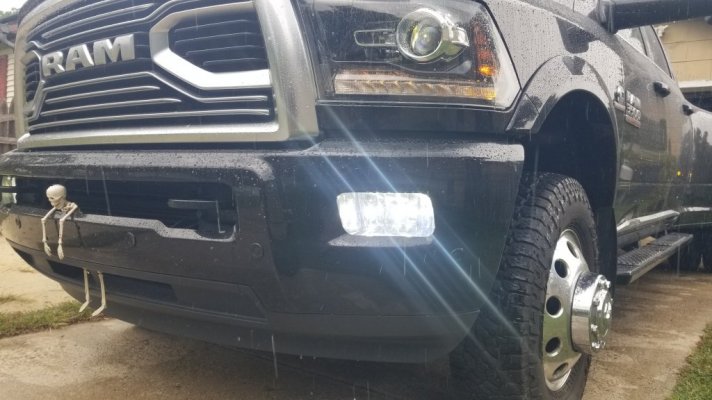

I replaced mine with yellow/white switchback LED. The way it works is when first turned on they're white. Then if you turn them off and back on immediately (tap the button) the go yellow. I like them alot and the yellow cuts back on glare reflection in my opinion during snow/fog. I have an HD truck so my lenses are horizontal in the bumper. Yours may be vertical lights and take a different bulb style.
Sorry, no nighttime pics.
Link from Amazon https://a.co/d/9aEwF4F

Nice, where did you get those? (link?)
Also the skeleton is a great idea.
