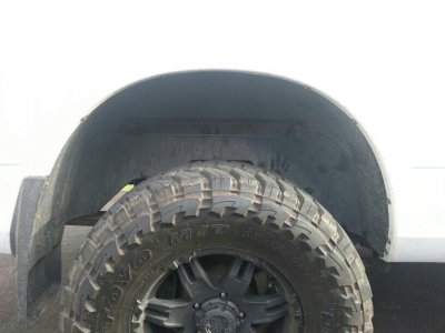

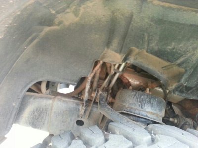

Anyone have any shots of a 3" BL without gap guards installed? I've read the rear is not bad but you might want to the fronts for sure. I'd like to see what it looks like before gap guards are installed.

I don't have any pics, but Ill give you my opinion. I originally didn't purchase the guards because I didn't think I would need them. WRONG, it looks like **** without them. You can see the nasty rusted exhaust manifold through the wheel wells, not to mention it would also be a ***** to keep the engine compartment clean. If you had a purdy set of long tubes, i think it might be a different story.
the rear DOES NOT need gap guards. The fender liner hangs just low enough to cover everything.

Uploading some pics I just took. I haven't had time to install my gap guards yet

Back isn't bad at all. Quite "perfect" actually. Front looks like ****!!!!

I agree, the front looks rough. Looks like something is missing from the wheel wells. Thanks for the pics and good advice. Think I'll get these together and install when I do the BL.

Yup. Mine would be on but I just haven't had time

Use Matt's method for the gap guards so much easier. Also those picts don't do the front end justice of how ugly it is without the gap guards and it is noticeable from a distance.

Hey White, thanks for those pics, ive been trying to find some to see what the before and after pics look like and if i really needed them. Im sold now, thanks again.

Np. At first I didn't order them. Then as I waited for the kit I got looking at the truck and decided to order them. My brother installed the bl but not the gap guards before I got home from Alberta this trip and it looks like **** without them.
