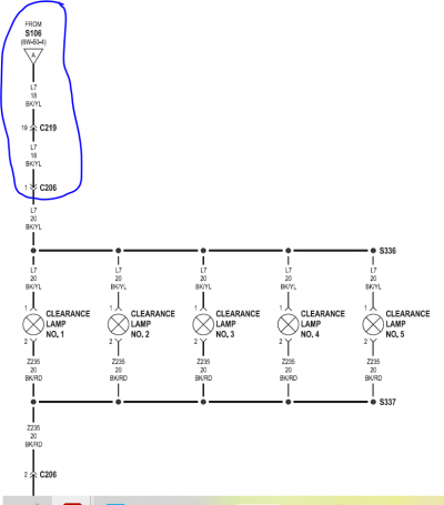

located inside the passenger side pillar next to windshield behind grab bar

It looks like C206 for the cab clearance lights. But depending on what diagram I look at it can either be on the left or right side. I don't see a diagram showing the connector attached to the A pillar like that, but when I look at the clearance lights and how they are wired, seems like that's what it would be.

Well thank you Sir !!!!!!!!! I would have never even began to think about that. That being said should it have 12volt power when the lights are turned on ? If so I might could use this supply as a fog light supply that did not come on my truck.

Check to see if you have fuse 32. It may be removed if you don't have the factory lights.
