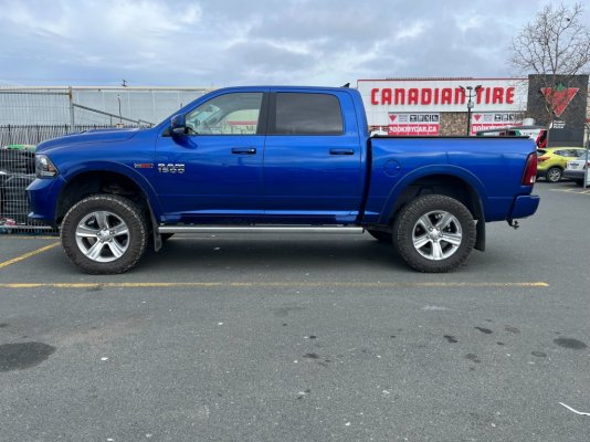

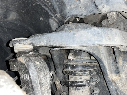

Those CV angles look pretty suspect. I know it's a silly question, but is there any possibility the installers left out the strut spacer because they (wrongly) thought the truck already has 5100s so no spacer is necessary?

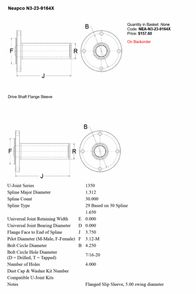

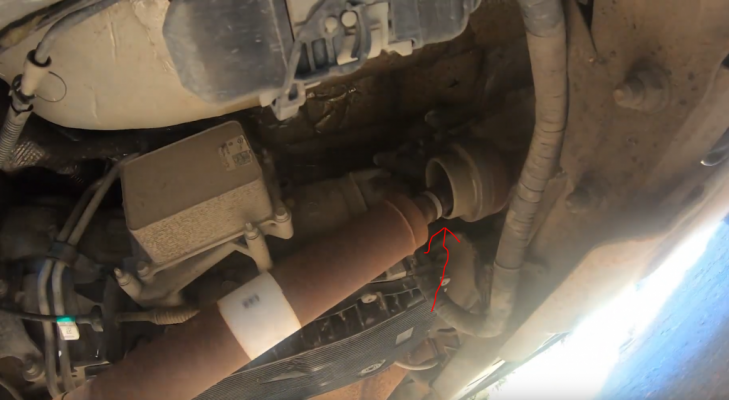

About the driveshaft... yes, BDS claims the warning was there all the time (it wasn't) and I bought and installed a 6" kit on my ecodiesel Ram. They recommended I contacted Adams Driveshaft which I did. As soon as my front driveshaft was replaced, the very irritating knock I had coming out of my front end disappeared.
Maybe you're onto something here, not a silly question at all. The installers were less than ideal to put it nicely (they left parts of the lift finger tight...) I'll get some pics of the strut, I'm assuming the spacer would be on top, visible?
The driveshaft sounds like a good idea too given the current noises seem to come from any motion in it. I'll take a closer look
