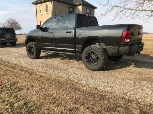

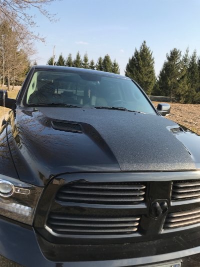

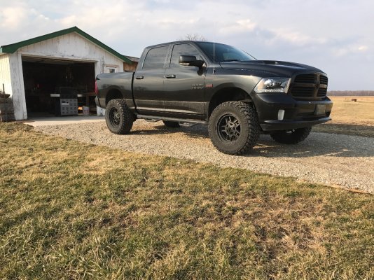

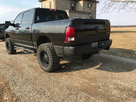

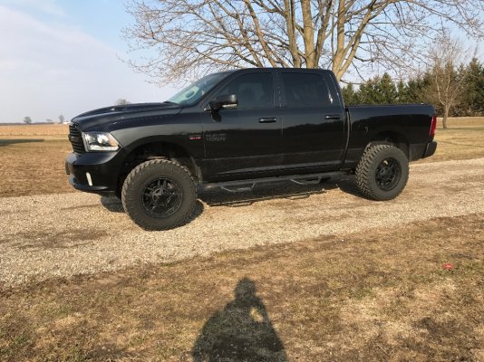

Couple updates pics 9b0a8d96b9f34ea340f7dbf16cbc046e.jpg8c86297c683610d4c85490cb890cf97e.jpg72825cde353dfc0a9bf8d58d76c2bf9b.jpg1a6dccac9ee8a23d7dd78bad92a20080.jpgb396befbc6d72481b6b261fb73989c82.jpg4a2c5e35360e217a4b739e9a98db693d.jpg
