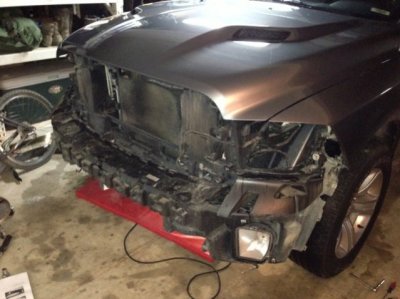

Took a little longer than expected but got the Zone 1.5 BL installed.
The instructions actually suck. Zone leaves out a lot of steps. Also not in the correct order, but it's easily figured out. Now since I have done it on this model, doing it again would only take about 4 hrs. Mine took 8 keeping it slow, taking breaks, and figuring out the rear bumper relocation. I was being very careful with the front/rear disassembly & reassembly to avoid any dings, or scratches.
With Impact tools for cab and bed bolts, majority of your time will be focused on the front, and rear end relocation.
RCX has better detailed instructions than the Zone kit, and you may want to refer to these as opposed to the Zone instructions.
If your about to install this and have questions let me know. It was the perfect weekend to get it done, as it's been pouring rain nonstop for the past few days.

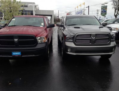

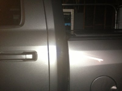

Here are a couple pics I took of just the cab lifted in comparison to the stock height bed.
I will try and get some better pics when weather clears up in a few days.
