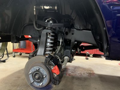

I’ll be quick and to the point. I leveled my ‘17 1500 with king coilovers and got some Zone UCAs to compliment them. I get it all installed and the UCAs are making contact with that weird outward lip on the edge of the coil bucket. So I try the one for the other side and it has clearance. Called Zone and they said I had them installed backwards (obviously) and would never get the alignment to be correct with them that way.
So I’m stuck in a predicament. Backwards UCAs that can’t be aligned and no clearance with them on the correct sides. I’m out of ideas on what to do and need some advise from anyone that’s willing to give it

According to the instructions the arms are side specific and the bj offset should face the rear of the truck. Hope that helps.

Can you post some pics?
The correct orientation does move the balljoint towards the rear of the truck.

should look like this. With the ball joint offset to the rear on both sides
