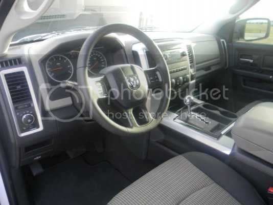

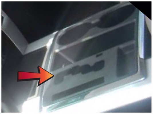

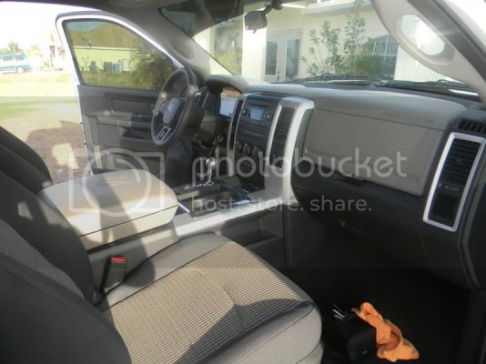

If you can find someone who wants to swap out the full console for the jump seat that would be the easiest. But if not you need the radio/dash bezel for the full console, console, the bracket to connect to the lower dash and floor, wiring harness to give power to the console, 2 front side panels and some hardware. Now if you get one with the center shifter and want to keep it that requires a few more parts which I'm not exactly sure what they are. Otherwise you'd need to find either a console out of a 2500/3500 or just the bin replacement. Ebay is a great starting point. You should be able to get the bezel and console no problem. The other parts (even the bezel and console) you might be able to locate on car-parts.com. if not there is a Mopar parts dealer on here and you should be able to get all the necessary part through them but it will be more expensive that way.
