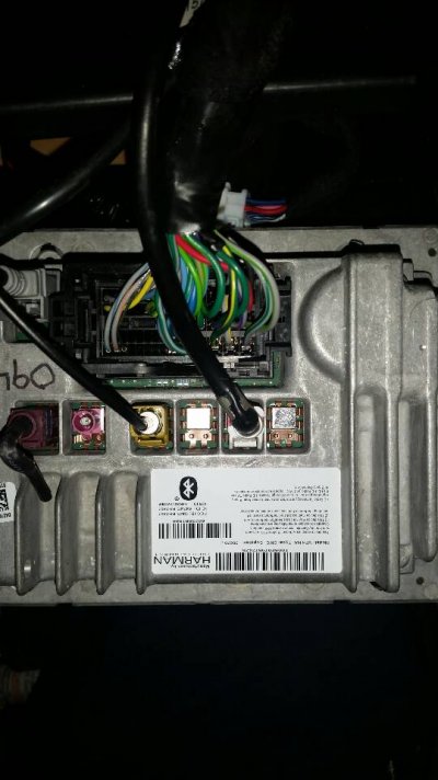

Here's mine with the C-1 connector plugged into the radio.
Hope this helps .
