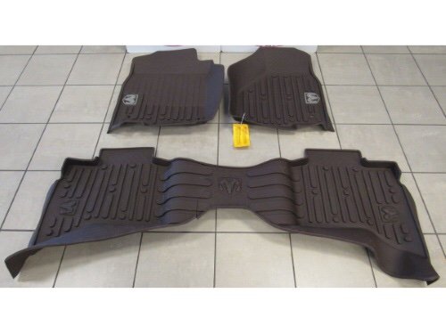

I’d recommend the mopar bucket mats, half the price of weathertech but twice the quality 9e85cf364d0db658cd346b606807179e.jpg
Are these the factory mats? When I got my ram new I had this big plastic bag in the cab and I just threw it in the shed as the dealer had installed the carpeted mats. Got to thinking about it the other day and went and dig them out and installed them. I was really impressed, really nice mats, especially beings that they were free.
