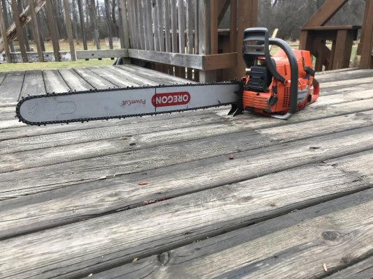

Did you use the chainsaw to cut it off the fender?
As seen in the synthetic oil thread?[emoji16]
Lol
I just love chainsaws [emoji2373]

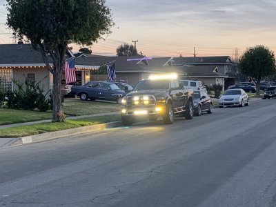

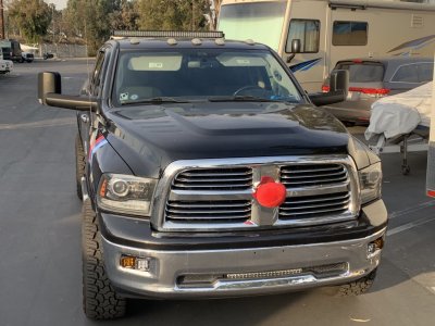

I like the bar, goes well with rack & steps!Installed a 50" LED Light Bar. Bounced back and forth between a straight Led Light Bar, or (4-5) round lights mounted on the headrack bar.
What's your thoughts?
Keep the bar? or go round?
