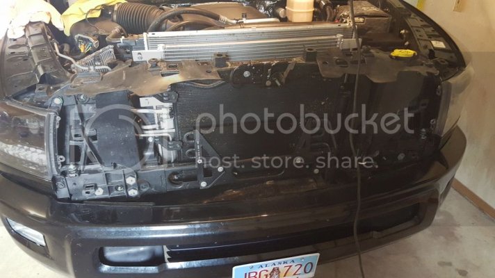

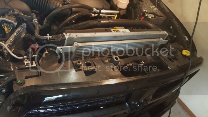

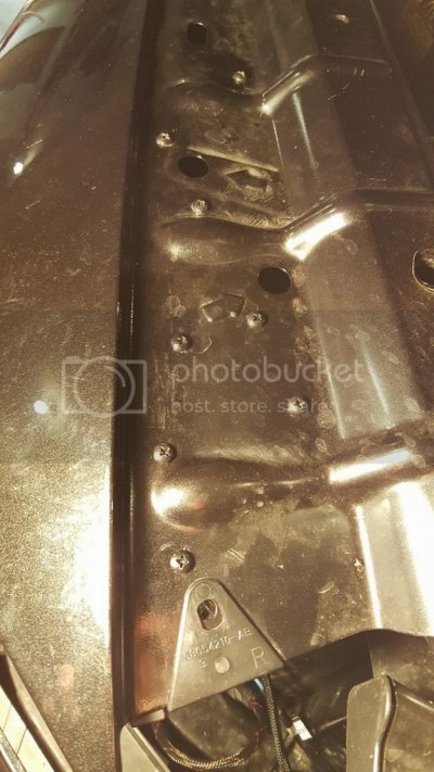

First I opened the hood and removed the plastic cover by removing 4? puhs pin inserts then exposing the radiator
I then removed the grill by taking out four screws on the top, pulling gently at the bottom of the grill after the screws where removed to release the plastic tabs then carefully lift it up and out.

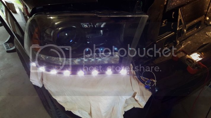

Before I removed the headlight housings I went ahead and attached the Putco Dayliners to the headlight housing. To do this I washed them with a soft sponge and dawn soap, then used the supplied alcohol wipe to get any leftover residue off. NOTE: The adhesive on these is amazing, and yet terrifying. once it touches, it STAYS so be extra carefull not to even brush up against the light housing while your lining them up or you'll end up regretting it, Trust me I know from experience :Frustrated:

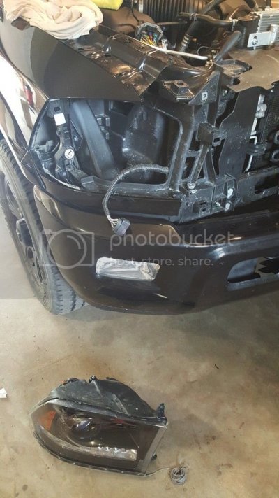

To remove the headlights there are two bolts per side, one on top and one on bottom of the light housing that must be removed and a plastic tab/lever that must be flipped behind it. To flip the tab you use the access port inside the fender-well, use a flash lite to locate the plastic piece and push it up. Then carefully remove the light

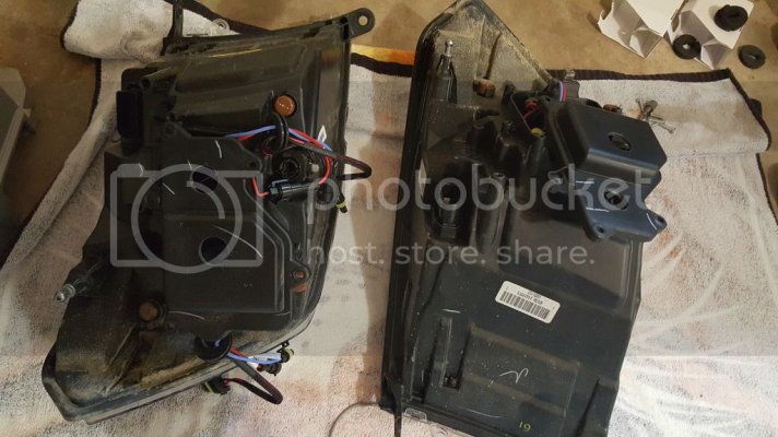

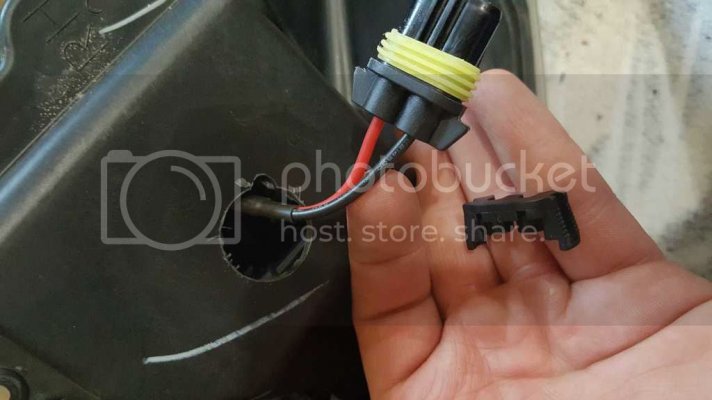

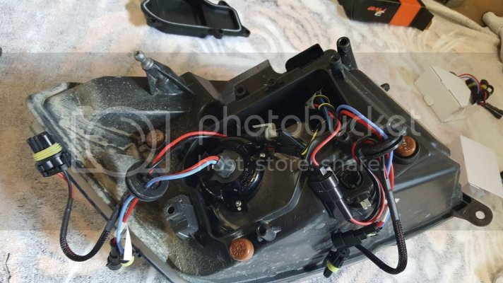

The back of the light is sealed with 5 screws, carefully remove them and set aside. replace stock lights with HIDS.

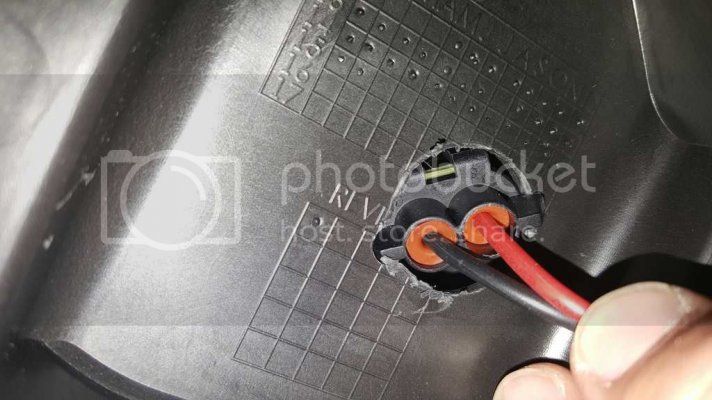

Then use a 7/8" holesaw on the light covers to run your wires.
You will actually need to use the holesaw pilot to add a small notch into the cutouts to allow one of the connectors through see pictures.
Then place the grommets and set aside, that was the easy part. The rust is much more fun!

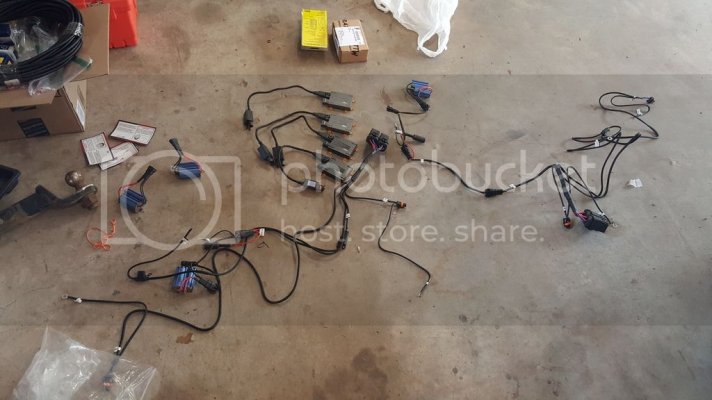

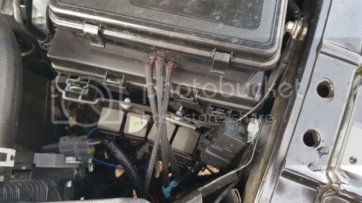

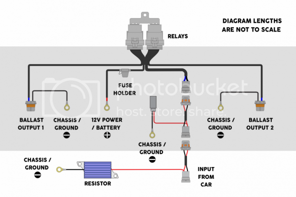

Heres the Fun part :suicide: Running the relays and setting up the resistors and ballasts.

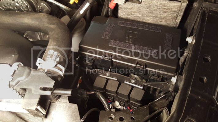

Find a place to attach the relays. I placed them on the front of my fuse box and then ran the wires to the general designated area. (In the picture you'll notice some velcro on top of my fuse box, I'll come back to that later)
The following image, and all Credits go to Retroshop, as it is a diagram off their webpage. I have linked this diagram for reference only as its not 100% accurate to the harness I had received.

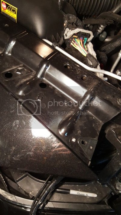

After the wires are ran you'll have to mount the resistors, I had chosen to mount them on the top of my finder well where it turns into the hood. I would recommend using stainless steel screws, and not zinc or any other 'coated' material as they tend to rust. (Another lesson from experience on my Ecodiesel where I installed these resistors in this exact same location. I'd also recommend painting the stainless steel screws to match the color of your body or there abouts. For example I have a black truck so I painted them black. I did this to help blend them into the truck. See pictures below. (On my old Ecodiesel the screws where eye sores anytime you opened the hood, or looked at the hood seam from a sharp angles, by painting them you create a clean image.)
(Painted vs unpainted)
NOTE: Be sure not to block any holes while mounting the resistors, they are used to adjust the angle of your headlights!

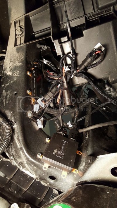

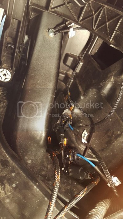

After the resistors are mounted you need to find a place to mount the ballasts. On the passenger side I screwed them into the plastic side wall shown in the picture.
On the driver side there was no where readily avalible to mount the ballasts so I ended up removing the drive side front tire well, and mounting the ballasts to the backside of the frame.
Now with everything to installed all I had to do was wire up the Dayliners, after cutting the wire to length, and stripping it I had to use a voltmeter to determine the correct wire to tap into. The instructions that came with the Dayliners stated blue with white stripe, but they were wrong. It ended up being a white wire with a redish/orangeish stripe on the passanger side, and on the drive side white with a gray stripe. Both wires where in the same position just different colors, I thought this to be odd but the Voltmeter tells no lies, and the ended up working just fine.

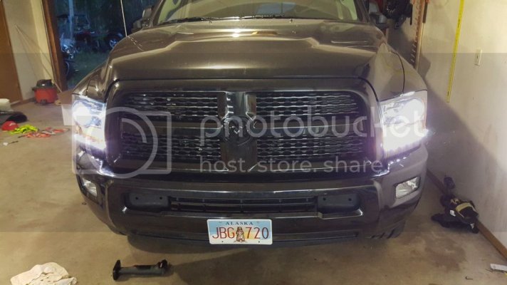

Before you put everything back together or move onto any other steps I'd suggest testing your HIDs, by either attaching the positive lead, or by holding it to the battery while some one turns the lights on, trust me, you'll save your self a lot of heart ache by testing them before you put everything back together. If they work slap it all together and call it a day. If they don't check all connections, then double check them... and then recheck them because you where blind the first two times.

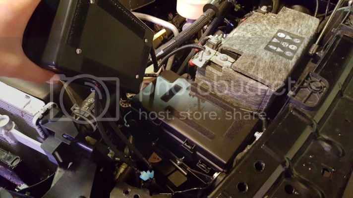

For me, I plan on installing a handful of other aftermarket components that will require being plugged up directly to the battery. On my last two vehicles the battery terminal was full of wires and it just looked like garbage, so I took a page out of sbarrons book like I mentioned at the beginning of this post and wired up a second fuse box.

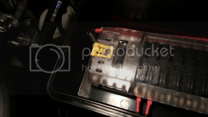

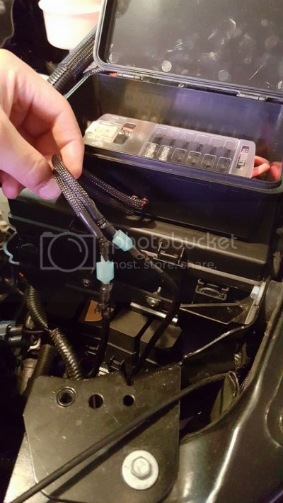

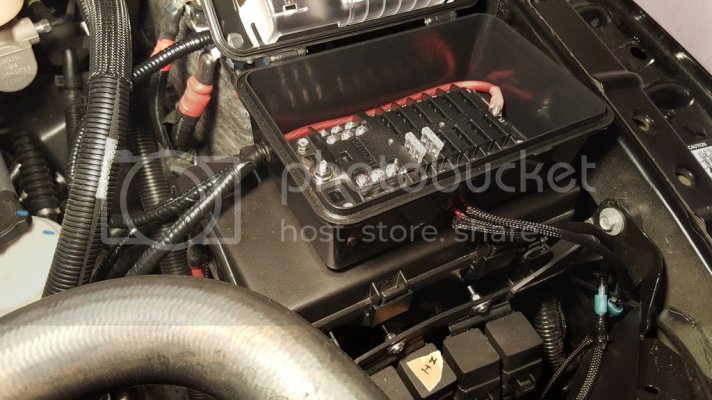

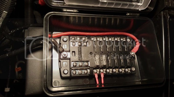

First I mounted the Blue Seas Systems Fuse block to the inside of the Weather Proof Box with 4 stainless steel machine screws. Then I washed the bottom of the weather proof box and the top of the vehicles fuse box with water and dawn dish soap, hand dried, and wiped down with rubbing alcohol to remove any renaming residue. Afterwords I attached the velcro to the bottom of the weather proof box, and carefully set it just where I wanted on the vehicles fuse box. I then took a heavy bracket and set it ontop of the weather proof box to apply pressure to the velcro while the adhesive cured. A few hours later I removed the weight and pulled the box off. (You don't need to wait a few hours, I just did this step before I started taking my truck apart so it could cure while I worked.)

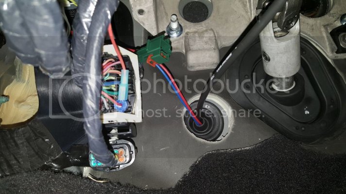

Afterwords, I took my 8ga wire and found a grommet that wouldn't take the wire without lube, drilled two holes in the front right of the weather proof box, and installed those two grommets, Then I repeated this process with the 16ga wire and smaller grommets. After all the holes where drilled I used a touch of dawn soap on the wire and forced them through the small holes.
I crimped the wires to terminal connectors? and used heat shrink on them for added protection. Seeing as the wires where so tight getting in I knew I wouldn't be able to pull them out of the box again without cutting the connectors off. So on all the side leads for accessories I have a quick connect terminal full of dielectric grease just encase I need to remove my secondary fuse box for whatever reason later on all I'll have to do is remove the positive and negative connections for the battery and disconnect the relay leads and away it goes.
I also used wire loom for all exposed wires, and wrapped that loom in electrical tape to match the stock appearance. The exception being the positive leads as the 16ga wire swam in the 1/4" wire loom. So I used some wire cover that I took off the Relay when I removed the Fuse portion of its cable.
Now any relay I wire up, or any accessory that needs direct battery power will have its fuse located in a specific location next to other fused for easy identification. And hell, it looks a lot better then having tons of lead wires every where.
And with that I had finished this install!
I'm currently working out some kinks with my HID lows, My EVIC is telling me I have a headlight out (the resistors are supposed to prevent that) but everything is working normaly. I just have to double check my connections...:roflsquared:

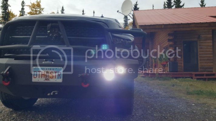

Finally got around to installing my fog lights, I've been procrastinating for almost a month but with my shoulder surgery coming up and winter almost upon us I bit the bullet and got to work. This is less instructional then my previous posts as I had a buddy help me and when that happens I don't take as many pictures and write notes and stuff. In fact most these pictures where taken after it was completely installed. So here we go.
Rigid X LED 4" square lights

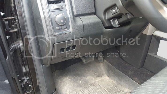

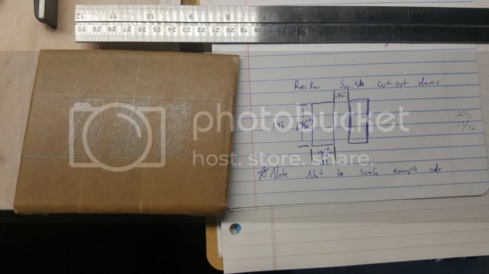

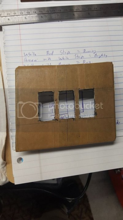

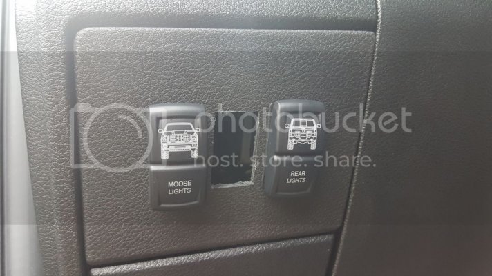

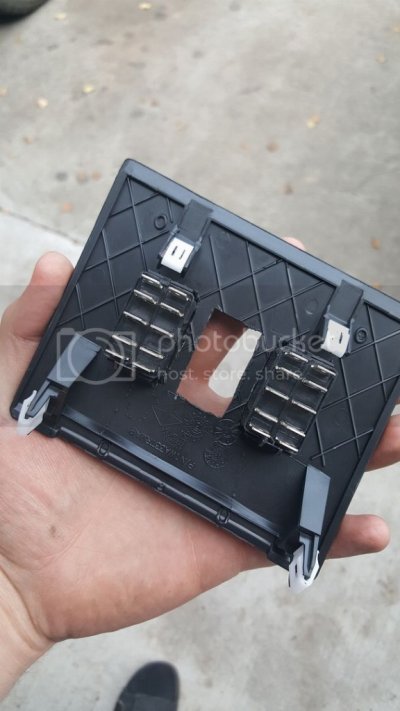

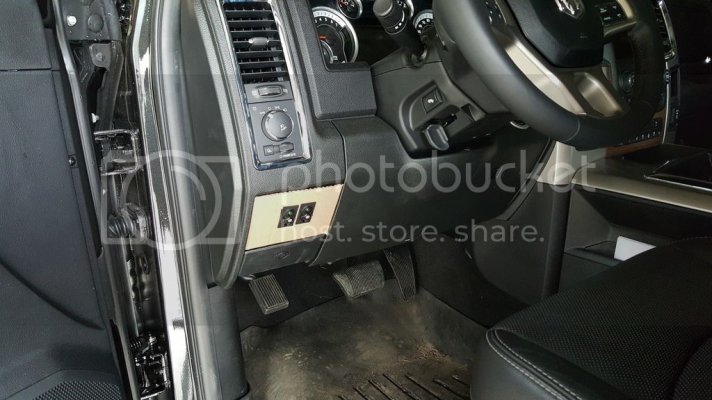

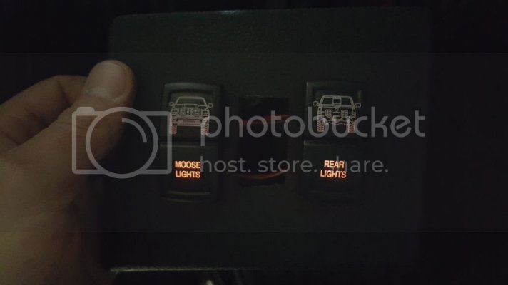

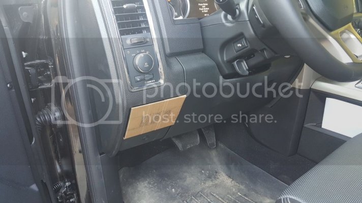

First I had to find where I wanted to put the switches, I'd of liked to cut out a spot for them under the dash but I was to afraid I'd screw up and then have an ugly ******** in my dash... So I decided to put my switches on a removable panel as I can replace those with ease. Various users here on RamForum made suggestions but I settled with the Access Panel below your headlight controls.
I first removed the panel and made a crude cardboard copy to not only check the measurements for the rocker switch cutouts, but to see how I felt about there location.
After deciding I liked the feel, I covered the access panel in tape, and measured out the cutouts. While I was doing this I decided that I'd go ahead and add a 3rd switch just encase I wanted to wire something else up later.
Then came cutting them out. I used my dremel tool with a mini saw blade. I made a few mistakes, but luckily the rocker switches cover them.
In order to get the switches to fit I had to file the sides of the cutouts as I accidentally cut them at an angle.

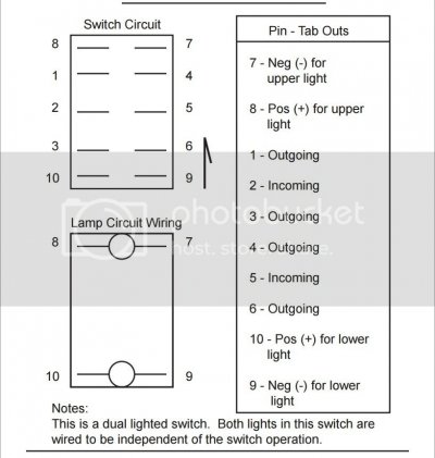

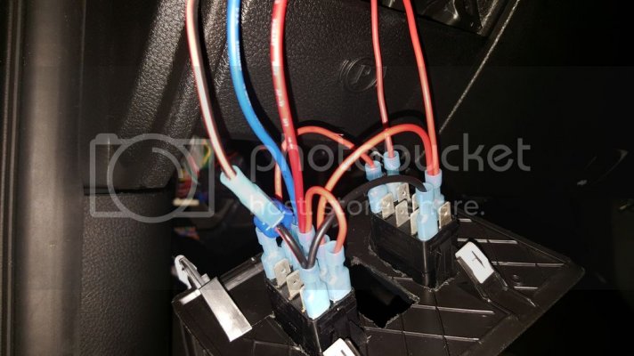

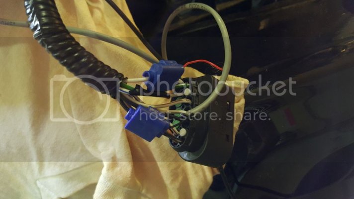

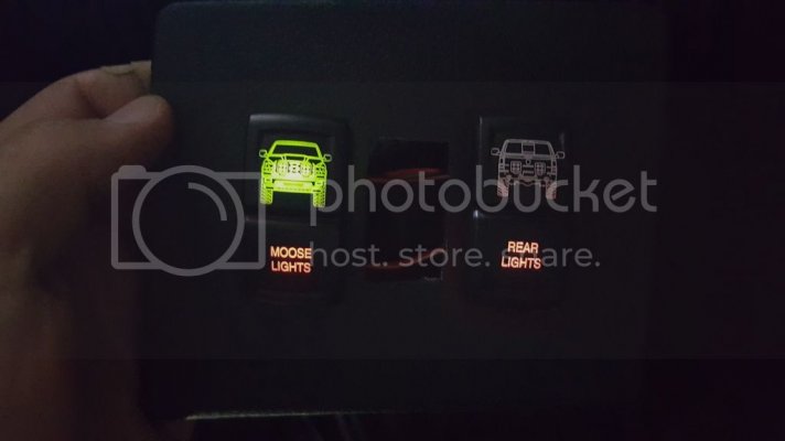

Wiring was easy but time consuming as I had to run a whole bunch of taps and share lines and blah blah blah. So here is the important parts. These are DPDT Rockers, With On / Off / On. I'm using them in conjunction with a relay to get my desired results of "auto" "off" "on."
I wanted the LED's to dim with the dash lights, however they run independently of the switch operation which I didn't release when I purchased them, meaning If I tap both the LEDs into the dash lights they'll constantly be on. Not what I wanted, So I decided to tap the RED led (which illuminated the words) to the dash lights as I didn't mind them being on when the switch wasn't turned on. But I Didn't want the top Green LED (the one that lights up the symbol) to be on all the time, only when I was using whatever it was wired to. So after much thought I figured out how to make this work.
As these switches are on/off/on DPDT I had plenty of room to make them work. Here is a diagram for a # reference on how I wired these.
#s 9 & 10 are for the Red LED, so I tapped 10 into the dimmer switch, and bridged it over to the second rocker switch, and will bridge it again when my 3rd rocker comes in.
To get the Green LED to work only when the switch is being used I had to revers what #s 1-6 did. What I mean by this is #s 2 & 5 became outgoing, and #s 1, 3, 4 and 6 became ingoing. Luckily these switches didn't have diodes so I could do this(diodes only allow electricity to flow one way)
In order to get you to understand how I wired the Green LED to be depending on the switch position requires you to understand how I wired the rest of the switch so...
I wanted the switch to work as follows. Down 'auto' (comes on with brights) Middle 'off' (Receives no power what so ever) Up 'on' (On regardless of headlights). In order to do that I purchased a typically relay to use with this system, I was able to get this to work by wiring the remote wire for the relay to #2, *ignition power to #1 and a remote wire from my brights to #3.
*I wanted ignition power so that you could only have it in the manual on position if the vehicle was in acc or run but was unable to find a tap under the dash, so instead its actually a constant power so I can turn on lights regardless of the keys.
Now with that in mind back to the Green LED. I actually bridged #8 with #2. In so doing any time the lights are on, the Green LED will turn on. Originally I only wanted the Green LED to be on when I turned the switch to the 'on' position but I actually prefer this more.
I also had to run a ground wire for the LEDS.

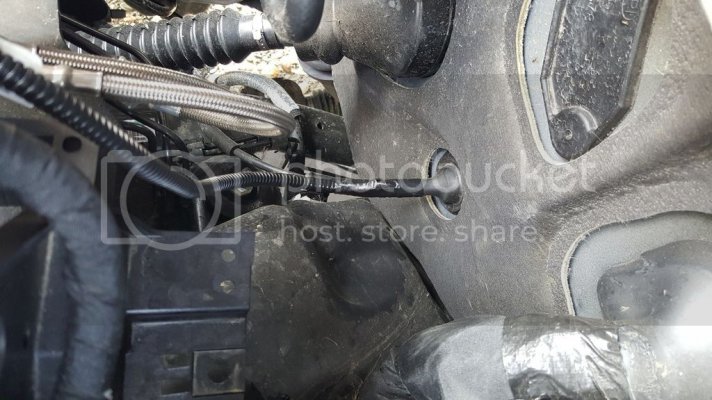

I ran the Relay's remote, and the wire tapped into my brights through this grommet, then on the engine side used wire loop and electrical tape. I fished it through with a wire hanger.
For the Relay I ran the power through my Fuse Block like I did for my HIDS
Switches in Action
You may be wondering why I wanted I wanted a manual ON for these switches. I wanted it more for the reverse lights then for my moose lights, but as I was going to wire it for the reverse lights I went ahead and decided to do it for both. More often then not the average person would wire an override off switch. However specifically for the reverse lights I wanted to be able to turn them on without having to start my truck, pop it into reverse and put the E-Brake on while I hooked up my trailer or what have you. I also wanted the ability to turn them on while driving forward to tell that SOB riding my ass to back up.
