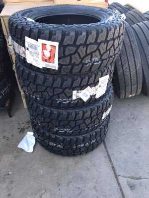

Just got my Bil 6112 in the front and 5160 in the read installed with Mickey Thompson Baja ATZ P3 35" (stock 20's), along with EBC heavy duty truck brakes yesterday (10/31). MOTHER OF GOD!!!! 2.5 inch lift from the 6112's alone, and it rides freaking fantastic. smooth, doesn't lean, is NOT harsh... the tires, zero hum even at 75mph. Im in bad street california (palmdale), this truck is WAY funner to drive now. The brakes, no more squishy, soft, wont stop type brakes. They bite flawlessly and with very little effort. No nose dive... and hitting a turn with bump doesn't send the truck bouncing all over. Very flat and smooth. LOVE IT!

Yeah I replaced both front and back. Thmotorsports.com best prices i've found. I took 1.5yrs to search, test drive etc etc. Since I don't do much romping other than to go in the desert to shoot, the bilsteins fit the bill. The tires I didn't want a stupid heavy tire like the toyo's, and mickey thompson is praised greatly.

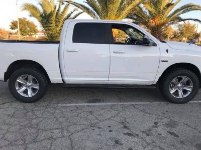

Are those 35x12.50r20? Any rubbing?
Sent from my SM-N920V using Tapatalk
They are just that. No rubbing with the Bils set one notch down from max. I've locked the wheel, hit bumps going fast, taken turns fast, etc etc. Never heard or seen any rubbing. No spacers in the wheels, it's stock rims. Real happy. Having it tuned and adjusted this weekend.
