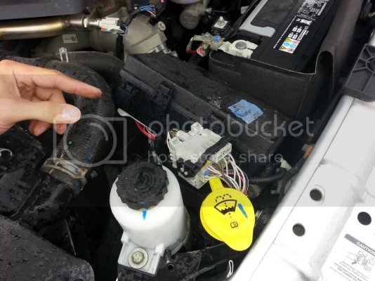

Here is a pic of the connector that it comes from

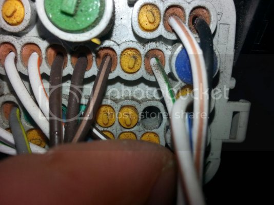

This is the backside feeding from the truck. Obviously on non foglight equipped truck on the corresponding side is empty.
Pin #23 is white/yellow, left fog
Pin #24 is white/orange, right fog
At first I thought the wiring was there but couldn't find the connector. But turns out that the headlights use the same color wires.
