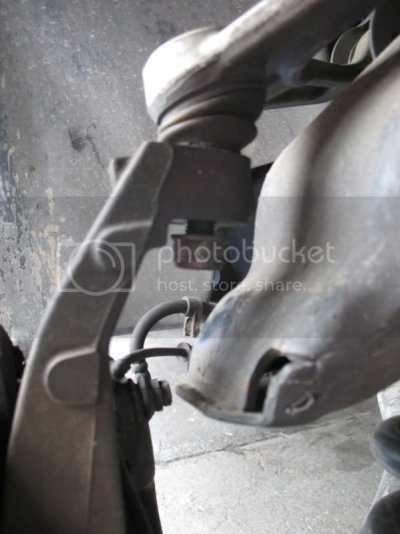

As some of you may or may not know, 3/4 and 1 ton trucks that are 2wd have independent front suspension that is very similar to that of a 1/2 ton. so when i leveled my truck, i used coil spacers. the lift placed my upper ball joints at a terrible angle.
due to this horrible angle, i have been through 2 new sets of ball joints. and also, as you know, dodge in all of their infinite wisdom made the upper ball joints permanently mounted into the upper control arm. so a new set of ball joints requires a whole new control arm. this requires entirely too much money to keep replacing.
the ball joints are at such a bad angle, with so much stress being placed onto them, that i am afraid of them snapping, and me getting into a horrible accident. also, the squeaking, grinding and clunking that i hear every time i go over a bump or make a turn is horrible.

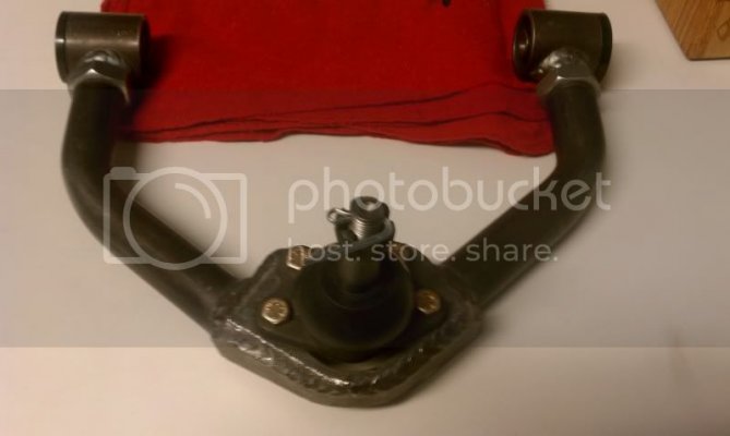

so, after many hours of searching for a relatively cheap/easy remedy, i have come up with these.
Lifted Upper Control ArmsShip Raw unless upgraded to Powdercoat
these are upper control arms with ball joints that are mounted at an angle in order to accommodate for the lift, and bring the ball joint back to an acceptable angle.

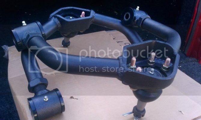

GOT MY UPPER CONTROL ARMS DELIVERED TODAY!!! woo hoo. and i must say... holy **** these things are HEAVY DUTY. airbagit.com, i am fully impressed with the quality of these parts. i recommend those guys to everybody. great service, great parts.
i got them in bare metal, didnt want to pay extra for powder coating. gonna paint them up before install. on to some pics.
hopefully ill have some time this weekend to install and align.

update on this project. they realized that they sent me a-arms for a 2nd gen. so they called me up, explained to me the situation, and had a prepaid UPS label in my email inbox all ready to go.
i slapped the label on their box and shipped it back. within a couple days i had my NEW new a-arms. this time for a 3rd gen, and with FREE POWDER COATING.
now, airbagit did make a mistake. but they caught it, informed me, and did the right thing in the way they handled the situation. great customer service the whole time. i will not hesitate to use them again in the future. on my way out the door right now to install. was out of town for a while and didnt have a chance. more pics to follow, and the low down on how they work out.

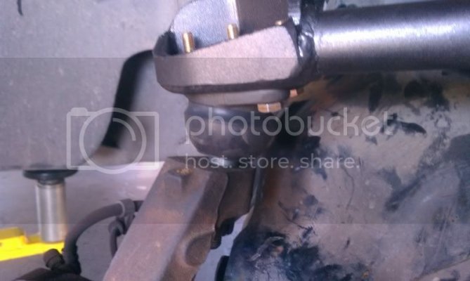

went to install today. everything was going perfectly.... then went to attach the ball joint to the spindle, ball joint is too long. ugh. took some pics, then took some measurements of both oem and airbagit parts. yup, these joints are 1/4" too long. give them a call, and shoot them an email with the pics and measurements. ill know monday morning what they are gonna do. most likely just send me the correct ball joints. they better hurry up though, i wont have my tools come Nov 9, they will all be on a ship on their way to japan.
OlDirtyJohn
OlDirtyJohn
Jun 26, 2010
1,518
52
Naha-shi, Okinawa, Japan
2004 Quad Cab 2500 *Sold*
this is showing that the ball joint shaft is too long. the nut was tightened down all the way, and there is still a gap.
other than this problem though, the arms themselves fit great.
