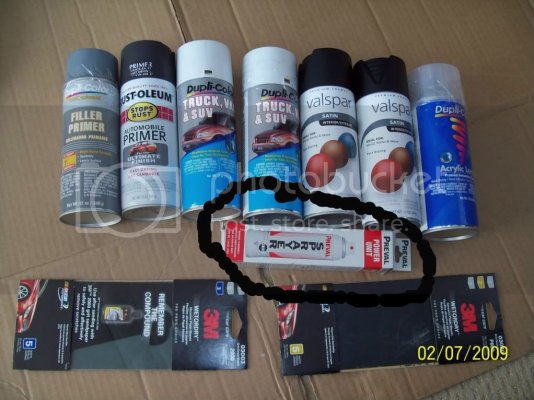

painted rear chrome after 3yrs and several f'ing parking lot bumps

i did it myself it was a long process the first step was sanding sanding and more sanding to get a surface that the paint will stick to get self etiching primer which is a must dont use reg it wont stick then did about 4 or 5 coats of paint and 4 coats of clear i used a rattle can for paint and preval spray system with autozone dupulicolor paintshop clear automotive paint that is in the can for the clear. rattle can clear sucks and doesnt hold very well
