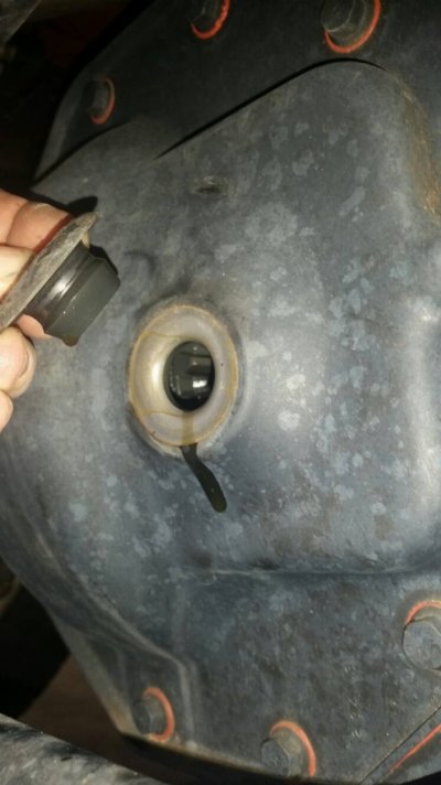

First I drove the truck about 40 miles to warm up oil and collect any metal debris on a small but powerful magnet I installed before I took off.

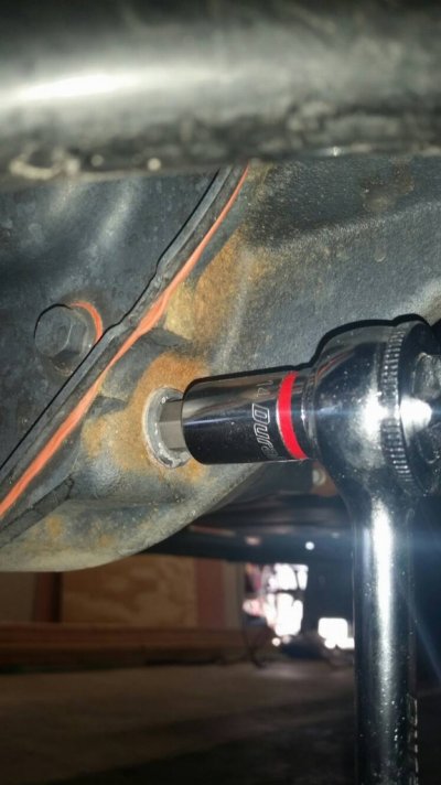

The rear drain plug is a 14 mm hex .
The filler port is a simple rubber plug.
3ec0116e549cd5354fe88461622fe563.jpg0e32f3be41ffb764e44b2a627bf55b50.jpg15f308cfccbd23549cb31f7dd501397d.jpg

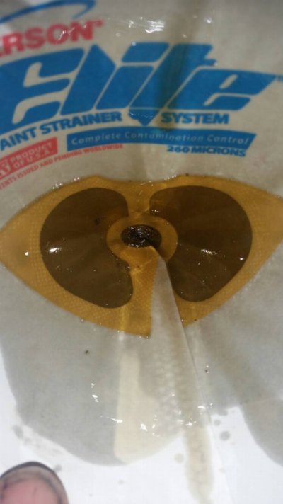

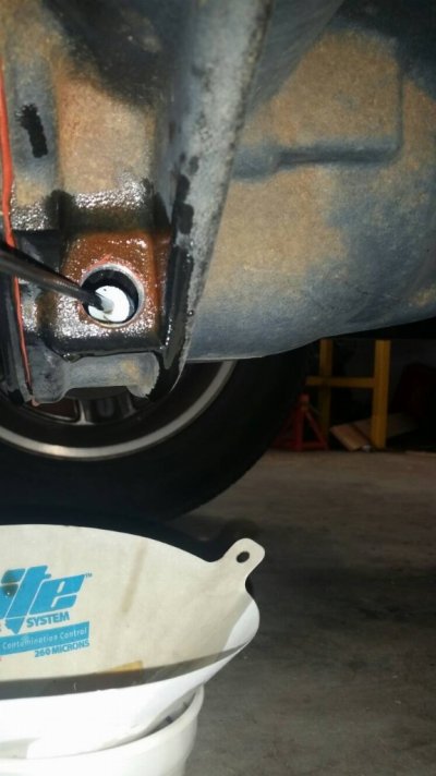

I removed the Maget draggi it towards the drain and drained all the oil through a paint strainer . Be ready it comes out in a hurry especially when warm / hot . About 2.5 qts.
Almost nothing in the stainer, just small metal debris , the least amount I've ever seen from a rear differential. I've only hauled my bass boat aprox 2,500 lbs fully loaded , and one 8000lbs camper pull for 45 miles for a buddy .
Next I ran a magnet everywhere I could and used it to pull out the remainder of the oil in the bottom of the case .

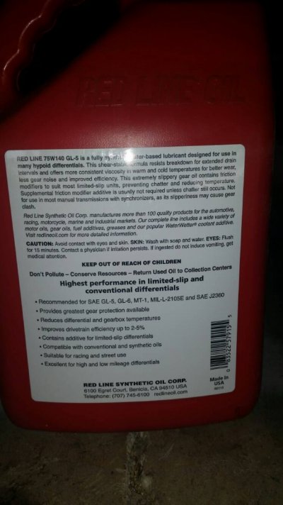

Filled it up to spillover out the filler port with Redline 75W - 140, this oil already has the Anti-spin friction modifiers additive for the clutch type LSD/ Anti-spin if your truck is equipped with. This oil also can be used in the non Anti-spin / LSD differentials as well. ☆☆NOTE☆☆ On the back of the bottle of RL oil it says if you have chatter in your LDS to add additional friction modifier . I have no chatter with my LSD .
Once done I went to a large parking lot and did 10 ea full lock tight turns in both directions , no chatter for me .

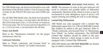

Great write up RLK! For the record, Ram LSD's do not need any anti-spin additives as they're a gear type LSD, not a clutch type.
Thank you Sir , I wasn't positive on that so I didn't elude to that on the write up .
roastpuff
Sep 24, 2015
207
133
Thank you Sir , I wasn't positive on that so I didn't elude to that on the write up . Thanks for the confirmation. I'll edit shortly .
The 1500 LSD's are clutch-type, whereas the HD trucks have a helical-type LSD. Check page 781 of the user's manual.
The 1500's do NEED the anti-slip additive.
