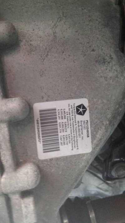

RLK here's the tcase pics. Fill and drain plugs are 3/8" square so any 3/8" ratchet or extension will work. Access to the plugs are on the driver's side, tag with case model number is on the passenger. As with the diffs, make sure the truck is level. Hope this helps!bf1ce75379028e6024e94b840338dfa9.jpga6d85589a5233efaa34f998519e77963.jpg

There should be a tag right on the tcase that says what case it is. I'll get a pic of that this afternoon too. The two tcases on 13+ 1500s are the Borgwarner 44-44 or 44-45. If you have the Borgwarner 44-44, you will need 2 quarts of special fluid from the dealer. It must be made of unicorn tears because it's $28/quart.
i have a question i checked today i have the 44-44 tcase the fluid you have pictured will it work in my 2014 and does it only take 2 quarts or should i buy three just in case ? I'm going to try to tackle the front and rear diffs and the tcase this weekend was going to use the mobil one for the diffs do i need the friction modifier as well thanks
The tcase takes about 1.5 quarts so you will need 2 quarts. Plan on ~$60 for that fluid.
Do you have the "anti spin rear differential" (posi)? If so you will need 5oz of of the additive so it won't chatter (unless you use Redline fluid). Should be able to find this on your window sticker. If you don't have posi like me, just grab some Mobil 1 fluid and refill with that. Hope this helps!
