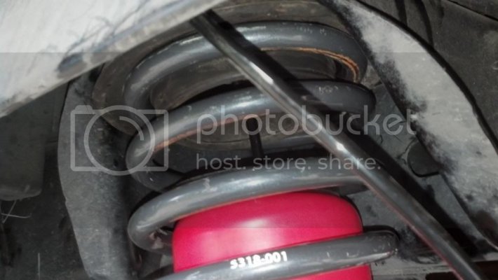

ok so i finally got a chance to install this on my truck and i couldn't really find a how to as simple as it is but i just found it a lot easier to take the springs out instead of trying to shove it in the spring like the instructions say to so i made this simple how to hope it helps some of you guys

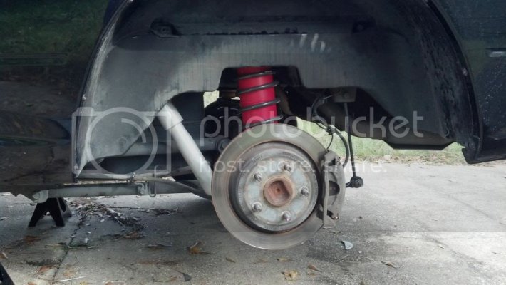

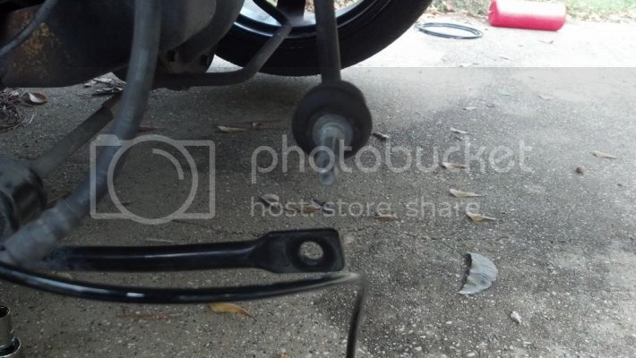

first things you do is put your truck on stands take the wheels off i didn't take a pic but i supported the rotor with the floor jack to lower it once i got the shock and end link off

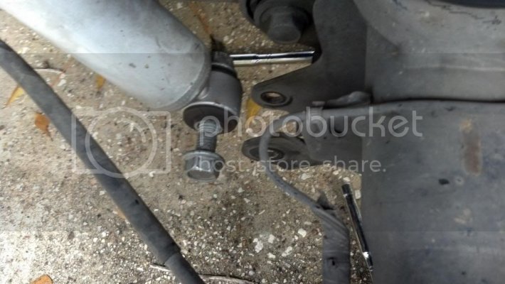

next your going to take off the bottom shock bolt i forgot what socket size
then take off the rear sway bar end link ijust use a crescent and 7mm socket

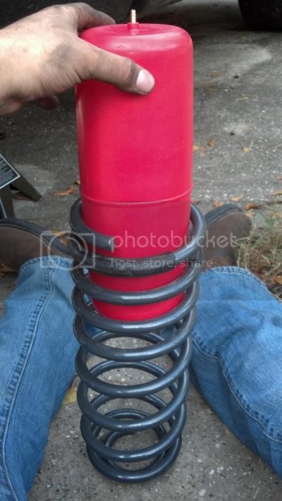

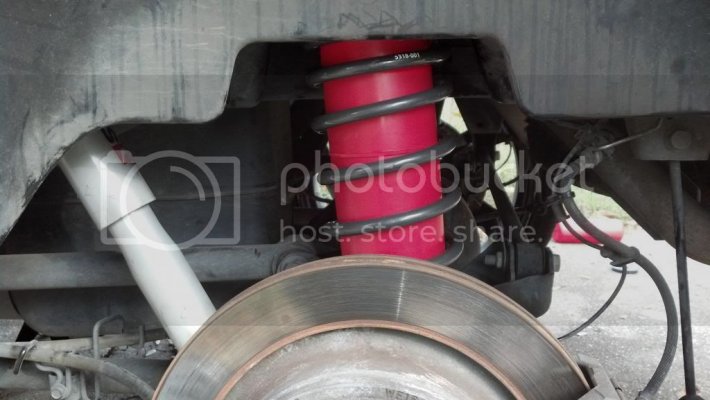

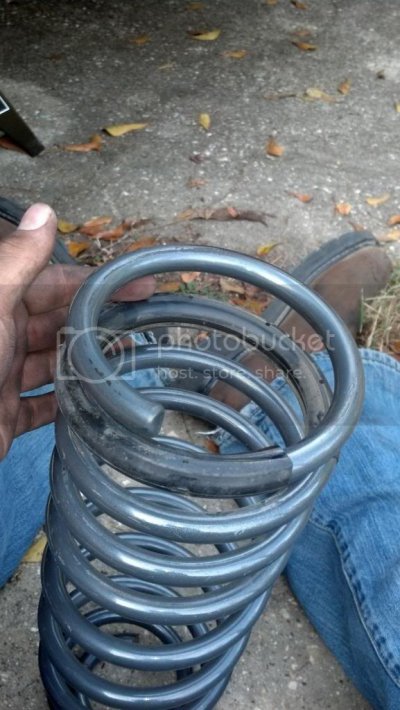

once you got those 2 undone and you lowered your rotor to have the spring fall out this is were i found it a lot easier to install my way the top of the spring is were you will put the bag

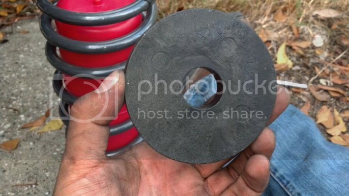

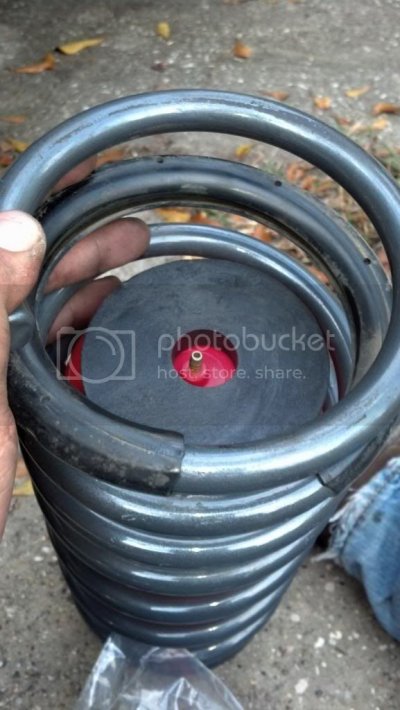

once you put the bag in put on the protector thingy
i forgot to take a pic of the air line but it goes over the brass barb on the top of the bag with a tiny hose clamp

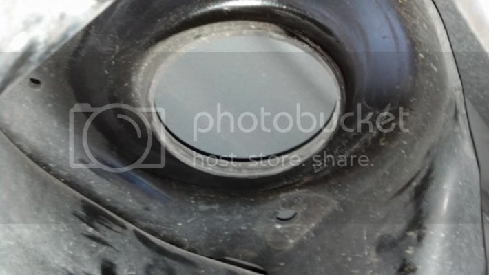

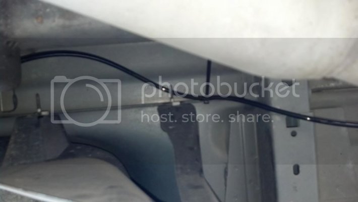

next your going to run the hose through this opening it is the center whole of the upper spring seat

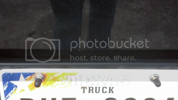

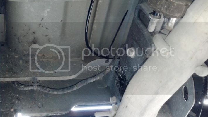

after that lift your rotor back up and bolt the end link and shock back on the start running your line i choose to run it to the back
i saw this from chaneys truck and liked the idea so i copied it lol
also i filled my bags to 30 psi before i set it on the ground that way it filled the spring as to not pinch or put the bag in a bind i drove around felt smoother got home dropped the psi to 10 drove around again still a smooth ride i wont get a chance to test it till we move again since thats when my trailer comes back out although its a small one i was just worried on bottoming out when hauling since im dropped

Why not install the 'T'? If one side fails I don't want the other staying inflated. Can't think of a practical reason for needing to balance a load.

Well mostly from time to tine i do carry uneven loads and if i had the t it wouldnt sit level i rather adjust it side to side mostly for my comfort

If you're going to 'Tee' the lines spend $4 and buy a brass 1/4" barbed tee union from almost anywhere. the plastic one they give you is just begging to cause you some headache.
