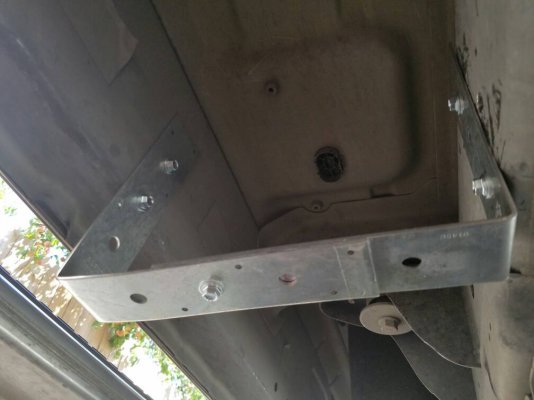

I struggled finding the right place to mount the tank but I ended up buying some pretty heavy duty L brackets from Home Depot and attached them to the underside of the passenger side of the truck with #10 1" Self tapping screws. Eventually I used a bolt, washer, the tank, another washer, a locking washer and finally the nut to attach the tank to the brackets. I used one of the bracket holes existing and drilled another for the other side of the tank.

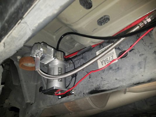

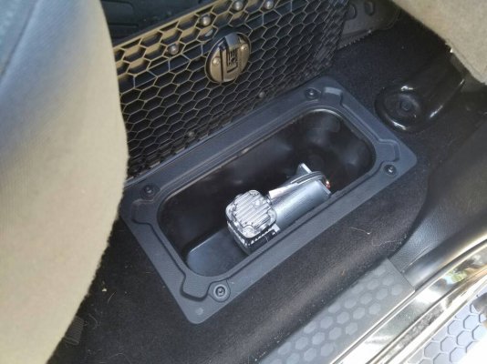

I decided to get crafty and use the storage bin under the rear floor mats for the compressor because I couldn't find a good location where it was close to the air tank and safe from a lot of water.
However it turns out that the compressor gets a little toasty and more importantly, the plastic bin acts as a sound amplifier and reverberates when the compressor is running and is somewhat uncomfortable when it runs, especially with the windows up and AC on. So the compressor got moved and I ended up using the extension tubing and flipped the compartment around and feeding the extension tubing in so the air filter will still be free from water and mounted the compressor further back on the frame with the same self tapping screws mentioned above. The only thing I may try to change is to add the provided bushings between the compressor and frame in perhaps preventing unnecessary vibration when the compressor is running, but I'm undecided in that... it's already much quieter on the outside. I used a flexi air hose to connect the extra distance and reach the compressor, also from Home Depot.

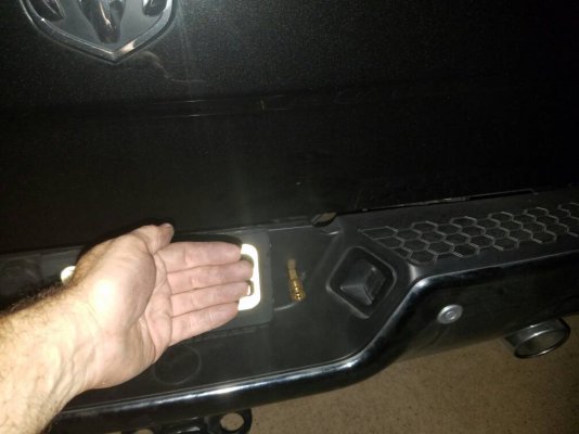

I ran a line from the air tank to a quick connect installed in the rear bumper for air tool connection, it's pretty handy to have IMO and pretty easy. I used a Universal connector from Home Depot that will allow automotive and industrial air tools connections.

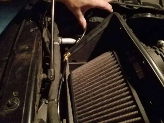

I installed the 1/4" tubing from the air tank into a brass T connector (from Home Depot). From that T connector, I ran one end to the train horns and the other end around the back of the engine compartment, the same place I ran the power wires. I actually was able to open the clips on the existing wire channel and ran the new wires in there and tucked in the air line. I ran that air line into the cab to the gauge provided in the kit.

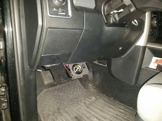

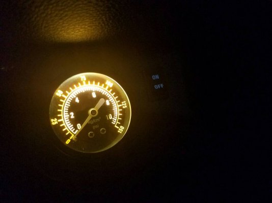

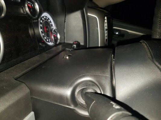

Inside the cab now, I connected the gauge(and compressor on/off switch) to the cigarette lighter line under the middle console because it's the easiest accessory line to tap into that I know of. I'm sure there are others but that's where I went. I also wired the momentary switch to on top of the steering column so it was within easy "smack it quick" reach but not going to hit it on accident. It's also wired to the cigarette circuit so when the truck is off, the horn won't work.

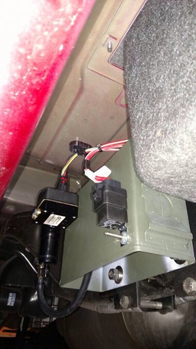

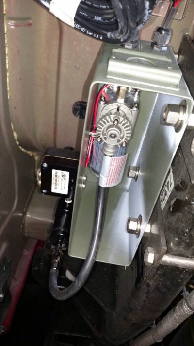

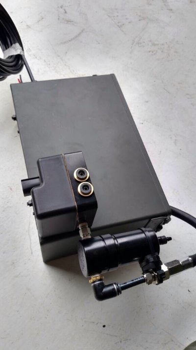

I installed my compressor in an ammo can to give it some protection. I fabbed up some 3" x 9" x .25" steel brackets that clamped to the frame, and I didn't have to drill any holes in my new truck. I did not install a tank (yet) but I'd do the same sort of bracket setup when I do.
The can also served as a great place to mount the regulator and relay.
I mounted the ammo can upside down and removed the lid. It is well protected, but is still ventilated too.
My compressor control is wireless and it works great. No signal issues. I plumbed the intake up to the firewall on the passenger side, up high.
