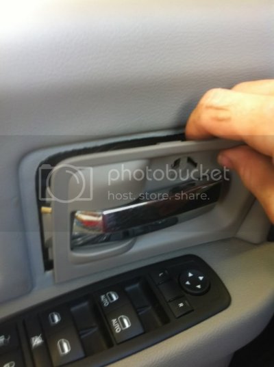

Open your door(window up) and the first thing i did was remove the screw behind the inside handle. It has a little cover on it that will pop up with a pocket screwdriver to reveal a phillips head screw.
Remove that screw than the cover behind the handle just pops out of place

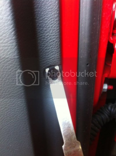

Next i removed the cover on the upper corner(nearest the mirror) just pop it out with a flathead.
Then there are these little body panel pins/screws that use a T20 and then pop out the backing of them.

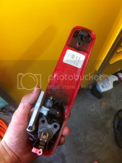

Now there is a third 8mm bolt on the forward part of the handle, but i could not get a pic of it so here is the layout of the holes on the handle off the truck.

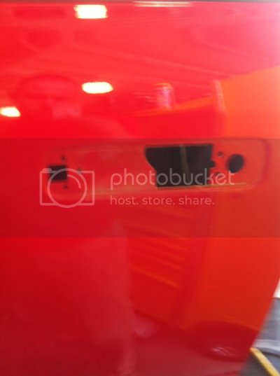

And what it will look like with no handle. I cleaned this before i put the new handle on.
