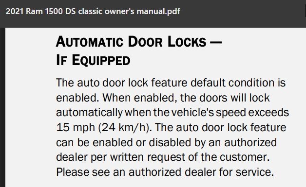

MPH is what triggers the auto lock when moving.
My truck seems like it’s tied in to rpm versus speed, definitely not saying your wrong, just mine locks at different speeds in my experience.
I almost always lock my doors with the when putting on my seatbelt before I take off.
I don’t idle my truck, wait for the rpm to drop and drive gentle for the first few miles, when I do forget to lock the doors it always surprises me when it does, I want to say I’ve gotten up to 30mph before it locked but sometimes under 15mph.
It could just be my truck, more curious than looking to be argumentative, I have been wrong more times than I care to admit.
Your truck may be different than mine, or maybe this is something we can investigate.
Just kidding and being an upstart. :cool:
