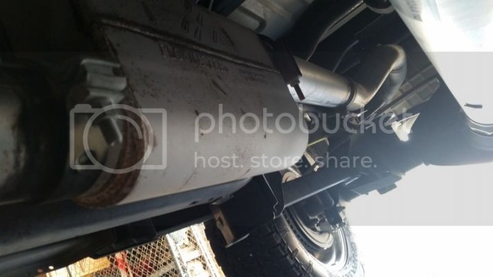

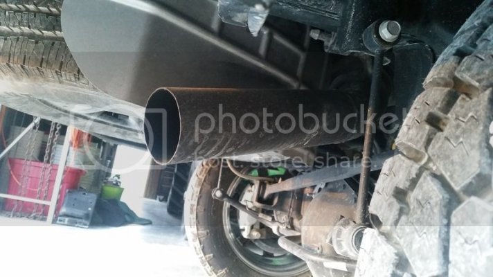

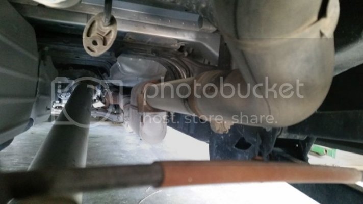

This is mine on my 2015 6.4L
I used the stock front section, added the Flowmaster and a 3.5" straight pipe to make up the length of the stock muffler. Then I used the factory over the axle pipe after cutting out the resonator. Welded in a straight 3.5" pipe the length of the resonator and painted that flat black with high temp paint. It now blends in and sounds great to me.

And MMM, your install is the one I was trying to find before I started this thread. Mine's the same except the shop added a section of straight pipe to fill in where the resonator was removed and welded the factory extension back on, resulting in the tip being in the factory location. It appears stock from the back and side except for the missing resonator.
