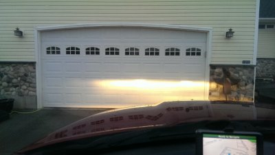

First of all, this is the light output of the old H11 bulbs.

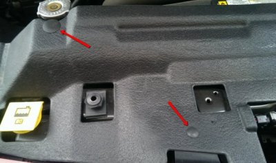

First step is to remove the baffle that goes in front of the radiator behind the grill. There are push in retainers that have to be removed, shown by the red arrows. There are three per side, about in the same locations.

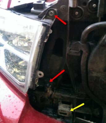

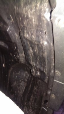

Next is to remove the bolts that hold the headlight assembly in place. There are two on the front, next to the grill. (Red Arrows)
Then there is a access door on the inside of the fender, a small push clip, the kind that has a center pin that you pull and the outer clip comes out. Once the door is open there is a bolt that holds the headlight assembly from there.

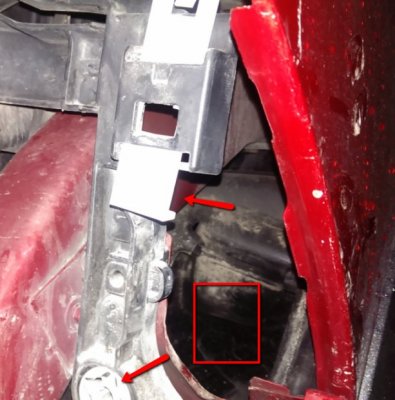

Once you pull that bolt, there is a lock tab that has to be pushed up to release the headlight. I took the picture from the front so that it is more visible, it almost has to be felt for as it is behind the bolt location from the access opening in the fender well.

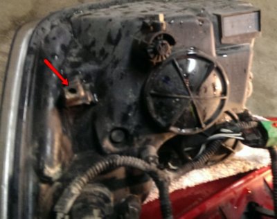

The lock tab holds around the end of the bolt tower on the rear of the assembly. The red arrow at the top. The square box is the access opening. The arrow at the bottom is where there is a push stud that goes into a hole in the support where the bolt is from the rear.

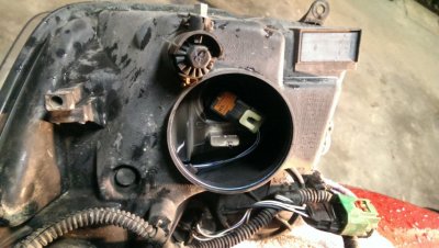

The large round access cover is where the low beam bulb, the H11 that will be removed.

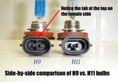

I borrowed this photo from another thread as I neglected to take a shot of the bulb socket that needs to be modified. As shown there is a tab at the top of the H9 bulb that needs to be cut out. I did mine with a sharp utility knife.
Here is a picture of the old H11 bulb in place and the new H9 bulb in place. The three tabs on the bulb side of the socket are slightly different on the H9, but if you use some finesse, you can get the H9 into the socket of the housing without to much trouble.

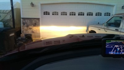

This doesn't really show the difference from the stock bulbs, but they are definitely brighter white. I tried to catch about the same level of light that was in the before picture. I can definitely tell the difference at night.
