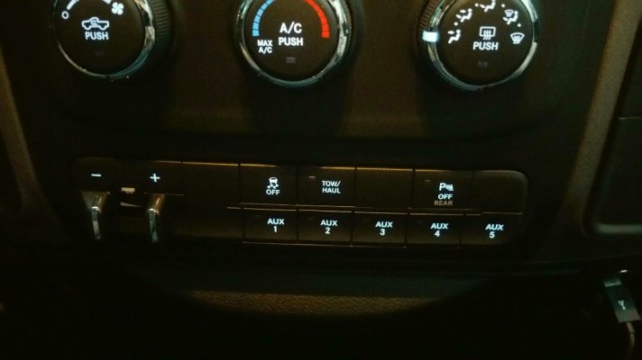

I am wanting to do the auxillary button mod on my '16 2500. But my local dealer is not willing to help me research the part number. I have looked through several threads looking for a part number for the switch I need but I have not had any luck. Does anyone know the part number for the auxillary switch panel for a '16 2500 with traction control, tow/haul, rear park assist buttons on top and the 5 aux buttons on the bottom?

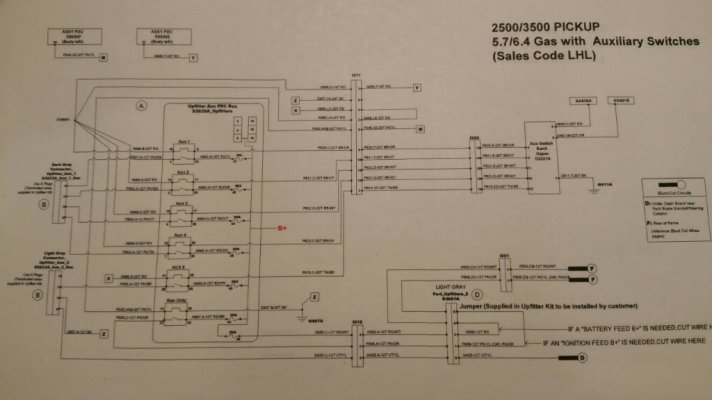

This is quite an undertaking, requires an additional aux pdc unit mounted under the hood, wiring harness and a sales code which may prove near impossible to get. Here is the directions for 14 & 15, don't think it changed much for 16. I do believe that it is one connector for all of it though yours may not have the wires for it in the connector.
http://www.rambodybuilder.com/2015/docs/ram/ramaux.pdf

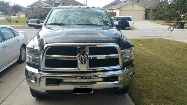

I wanted to follow-up on this post to say thank you to Yoda and Magician for thier assistance. I was finally able to complete my auxiliary switch install and everything work perfectly. The part number provid ed d by Yoda was the correct switch and the pictures provided by Magician were a big help. I am still waiting on a relay block to arrive to make the install look like it is completely Oem. But the functionality is already in place.

I found the following wiring diagram on Ram Builder. That helped with building my harness.
Aux1 - pin 3 br/or
Aux2 - pin 2 br/vt
Aux3 - pin 11 br/wt
Aux4 - pin 10 br/gy
Aux5 - pin 12 tn/br

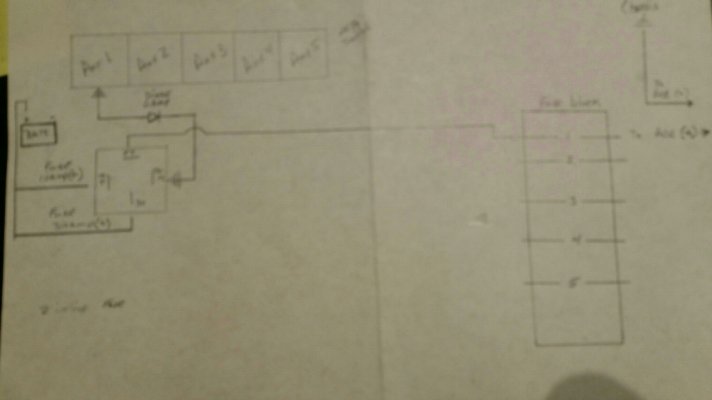

I did not have to add the sales code for the switch since my harness goes directly to each of the pins. Each button applies a ground to the coil side of the relay when applied. Below is how I wired each switch

Aux 1&2 will function with the key off, 3-5 require the key to be on

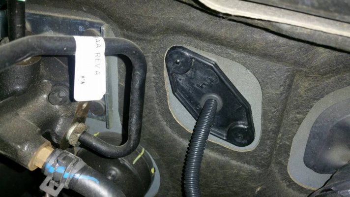

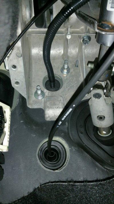

Here is a couple pictures of how I ran the harness through the firewall by going through the clutch delete plate. It is plastic and easy to drill.
