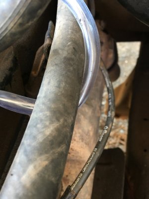

. Still no oil on plenum . Put the clear hose ran across town and back no oil in it either . Changed pcv valve also . This one has me stumped .

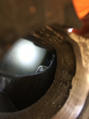

I removed the plugs in order . Maybe it’ll help having more information. I pulled of passenger side valve cover and it looked really really clean . No broken rubber laying around . Seals looked pretty tight on valve stem . Stem was shiny where the oil was wiped clean. No obstruction in oil tubes.

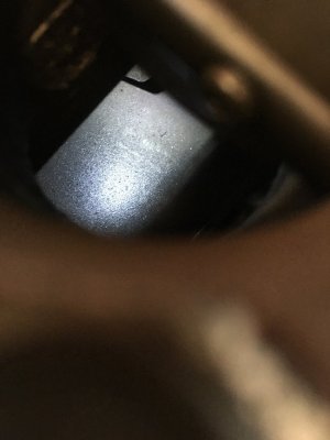

Ah ha so pulled throttle body off now I see oil pooling at the back . This must mean it’s bad correct?
pacofortacos
Apr 18, 2017
3,619
4,442
That actually looks incredibly clean in there, does it look like the intake has been off before?
Or is it just the picture?
At idle you have high vacuum in the intake, but you really don't have much oil flying around under the plenum and not much air flow in the manifold to lift the oil to the cylinders.
At higher rpms you have both of those things happening and really high vac. on decel.
It could just be a piston with the rings worn/stuck too that would cause it smoke under load.
I will be honest though, the engine at those miles will need rebuilt and new heads if you want to fix the low compression issue. May be as little as a re-ring job and new heads but plan on cylinder heads either way if you tear into it.

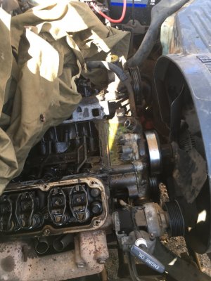

got intake out don’t see a visible failure of gasket

Might as well put new valve seals while I got some room maybe it’ll help. Thank you guys for the help! I did a thorough compression test I don’t know why it differed from the first . Started a thread for that but no reply’s .But with ign. Fuel disconnected .completely warm engine. 6 sec. cyl. Throttle wide open. And for wet 3 squirts from oil can . Spec says 100 psi is min. I think rings would last a bit longer . I hope.

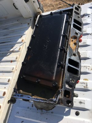

I just notices the photo of your plenum pan.... do you see all that oil sludge on it?
100% your oil control rings... are filled with that.
you can try seafoam treatment, or you can just re-ring it.... my suggestion....if you are going to go as far as a re-ring...just have the motor rebuilt. it will provide many more years of reliable service, and the motor will probably outlive the rest of the truck at that point lol.
