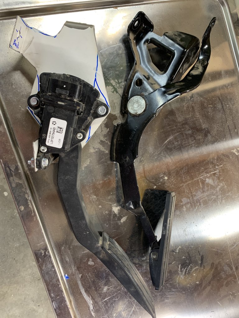

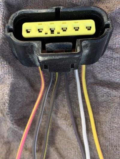

The original connection on the left with the red insert is smaller and tighter pin grouping, 2003-2004. The next connection on the right with the yellow insert has larger pins and wider spacing, 2006. Naturally, wit colors differ as well. Oh, did I mention the unique bracket to adapt the pedal? I may need to buy a service manual like I had for my ‘89 Ram to get an improved schematic. I’m sure this can be done, Dodge must have a fix or adapter kit. But I’ll work with what I have for now.
So, I found a couple of wiring diagrams shown below, for my attempt to use a 2006 gas pedal in place of the 2003. I'll need to look at extending the wires from the battery area to inside the firewall. When I pulled the 2006 gas pedal, I cut the wires from the 06 wiring harness. Glad I did as the connectors are not the same. Now I'll use the attached wiring diagrams to splice into the original wiring. The plan is to leave the original and splice in for the extension to the 2006 gas pedal. The pedal is really easy to swap over; since two 13mm bolts hold the pedal in place. The electrical might be a a bit tricky. I'll keep posting updates as I work through this. it it works or not... I'll be straight-forward with what I end up with.
